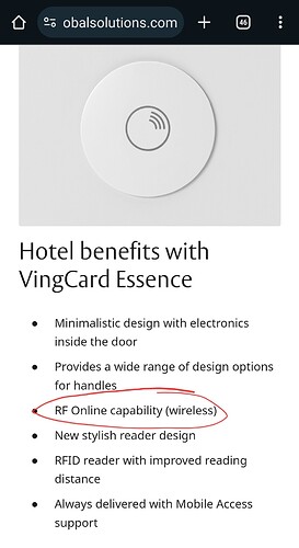

does it look like this?
I know that for my lock at home (also battery powered) I can buy an add on WiFi hub, with which I could add additional locks, and control access to all connected locks; this might be how your ones are “networked”
I’m not saying they are, just a possibility, and to me the more logical way to manage access rather than on the card itself :man_shrugging:
You might need to do some sleuthing :mag_right:
Yes, that is my system, but I am 99.9% sure they are not networked.
Mgmt needs to come to the unit to program it when the key fob is lost and needs to be changed (I assume the other line item keys that match between cards). Mgmt told us they are not networked as it required extensive infrastructure and cost, the common wifi does not reach to all units to be networked and they are not wired. Thanks for the interest and help.
Good Sleuthing
That is super inefficient…
That confirms it then.

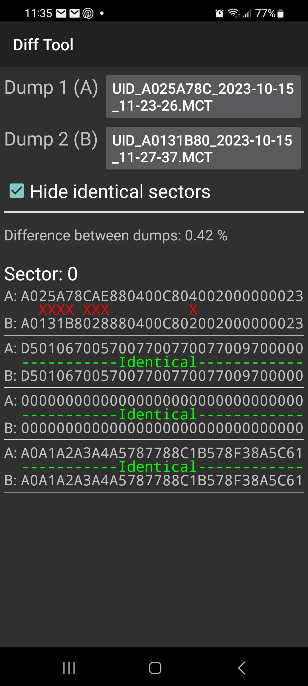

Can you try using MCT!?
Scan both of your 2 day and 7 day tags
and use “Diff Tool” (Compare dumps)
and share the results.
I’m hoping it will see something you didn’t
Ohh.
Thats a good idea. I had to hand back in the 2 day card to get the 7 day one. I will try to keep the 7 day one and get another card (Not 7 days) soon and post the results in a few days. Tks again.
OK well, I made copies of the cards and compared them. It did not find lines 7, 24, 25 & 27, they were all zeros, so they came up identical. The only differences it found were in the UID.

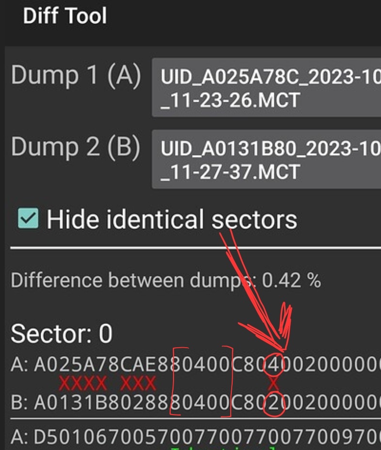

And this
Hmm, Interesting. I discounted that as its part of the cards manufacturers data, but if the lock is using that and its programmable, then that could be it. I will look at other cards I have copied and see what they are, modify it and get back to you. Thank you
You could be right, but off the top of my head, thats the 80400, but I would need to look at the data sheet to confirm
My hunch is that byte is part of a calculated check. Look through the spec to find out for sure though… I’m mobile so I’m leaving it up to you :slight_smile:
