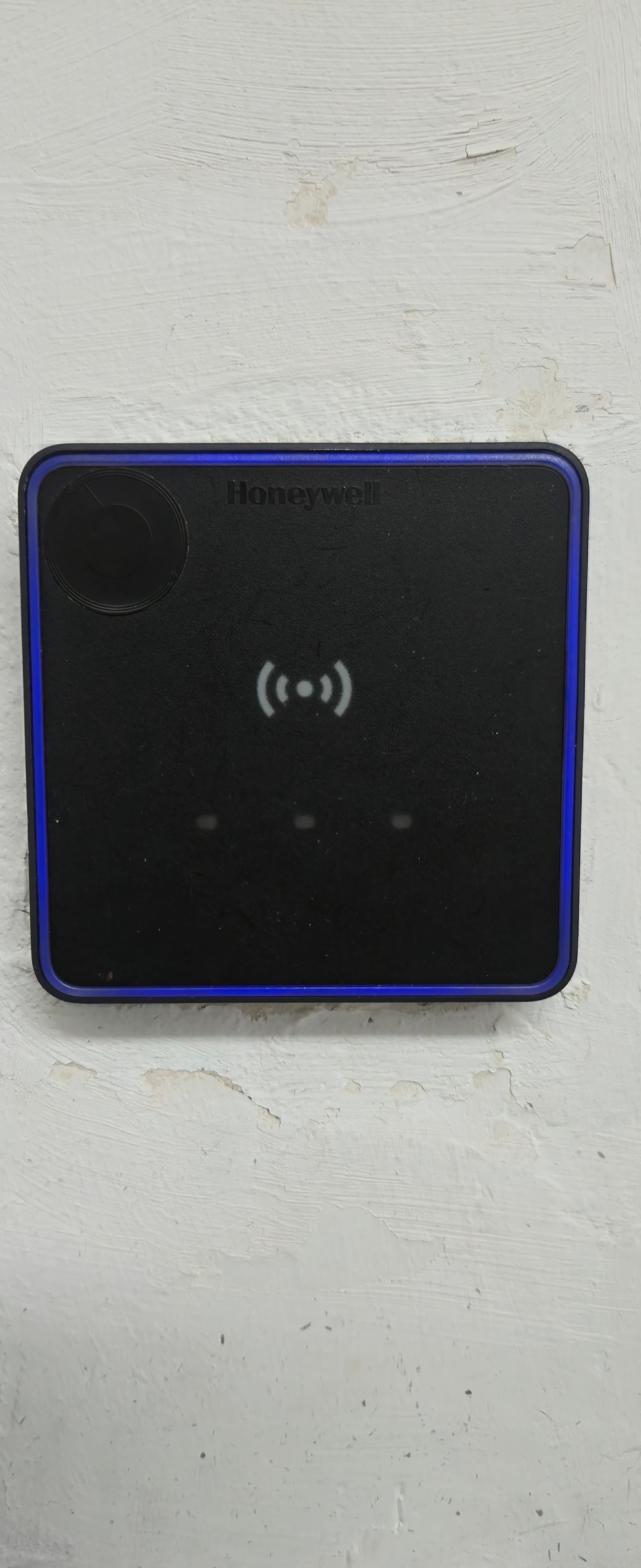

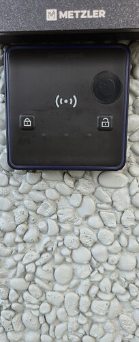

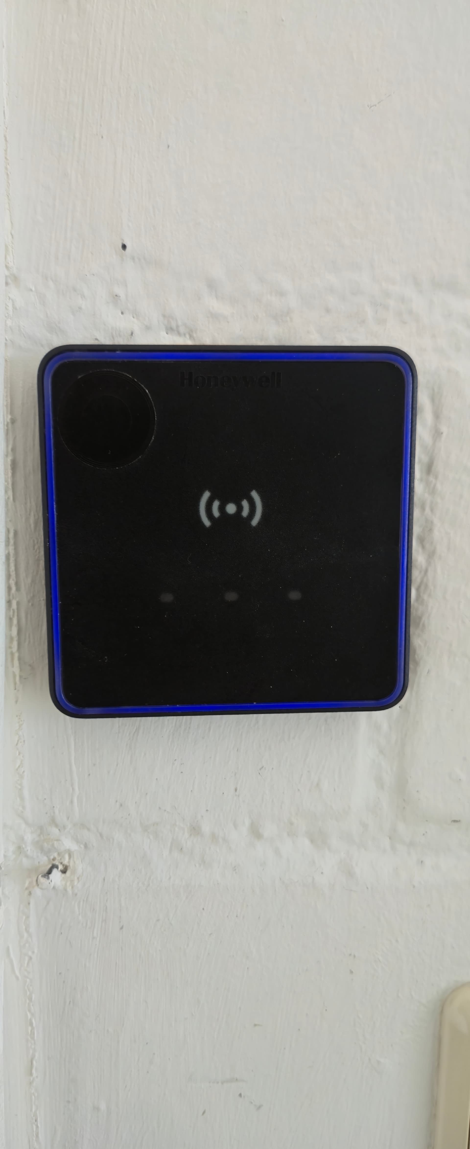

Hi,
here are the pictures. Yes I almost exclusively use readers without a keypad as we don’t use the pin. In the outside area there are 4 readers for arming/disarming but also without keypad as the sticker would not hold here :wink:

Yes, the readers with keypad can be a problem. As we only arm/disarm using a transponder without a key, I had the readers with keypad replaced in good time. The winding of the antenna is also different here, as can be seen in the picture.
You also have to be careful not to have this small roof (rain cover) fitted to the outdoor readers. The readers do not need this as they are potted. Depending on where the chip is in your hand, it may get in the way.
