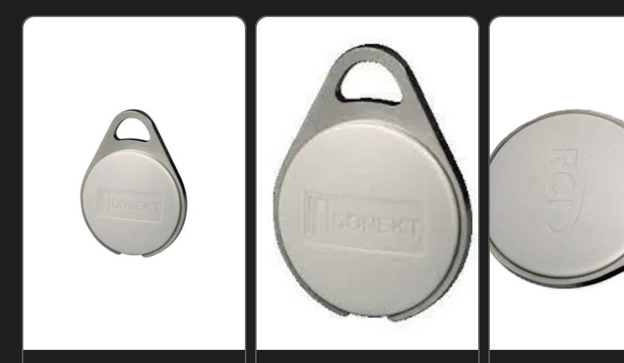

Hi I’m a newbie, is it possible to copy a Mifare desire key fob? I tried using a xixei x7 and it kinda reads it but says it has encrypted sectors, is there any way to read the encryption and clone it?
I could clone it with the x7, just not the encryption part:(
When I try it on the lock, it only beeps, won’t unlock.

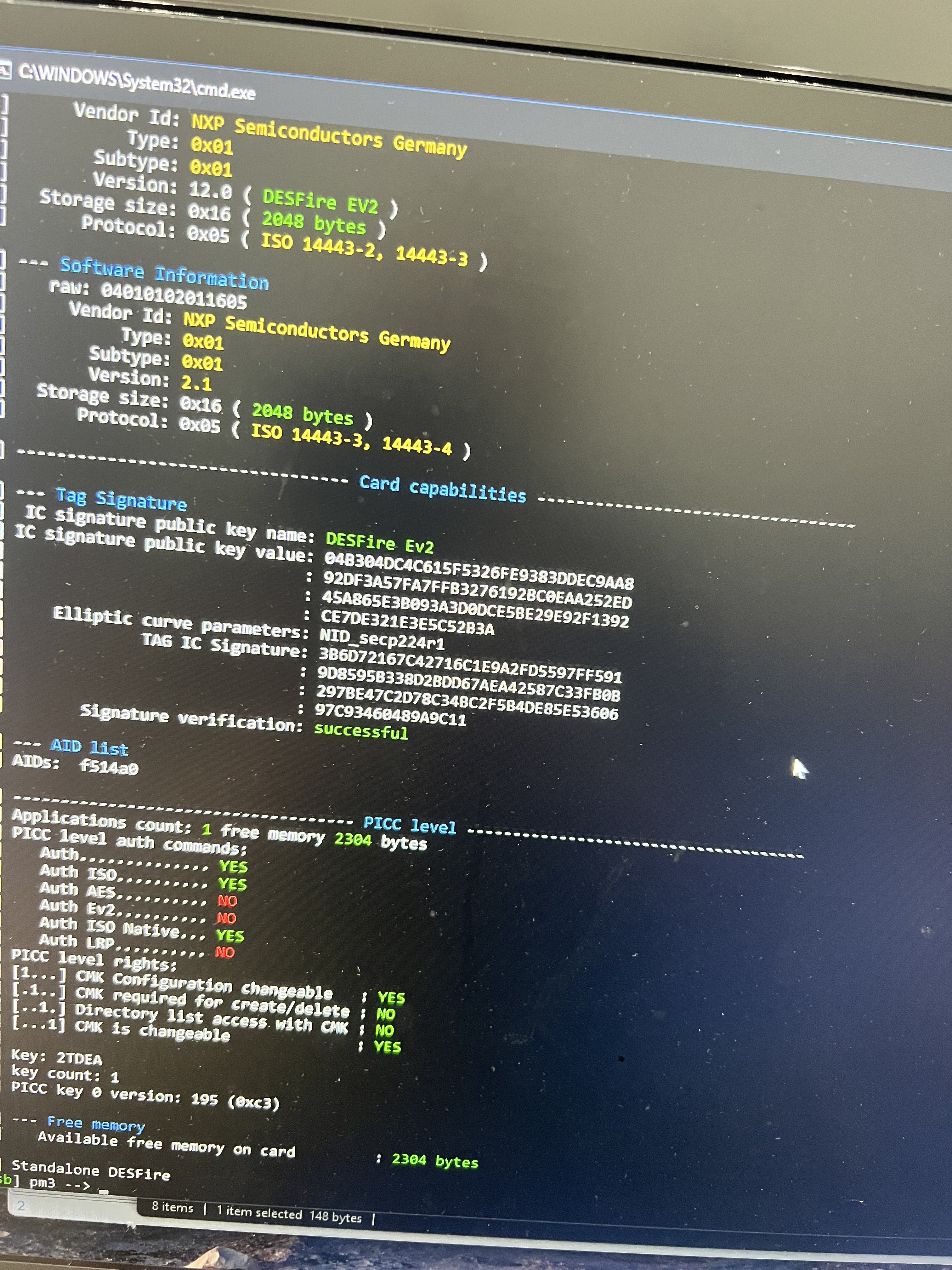

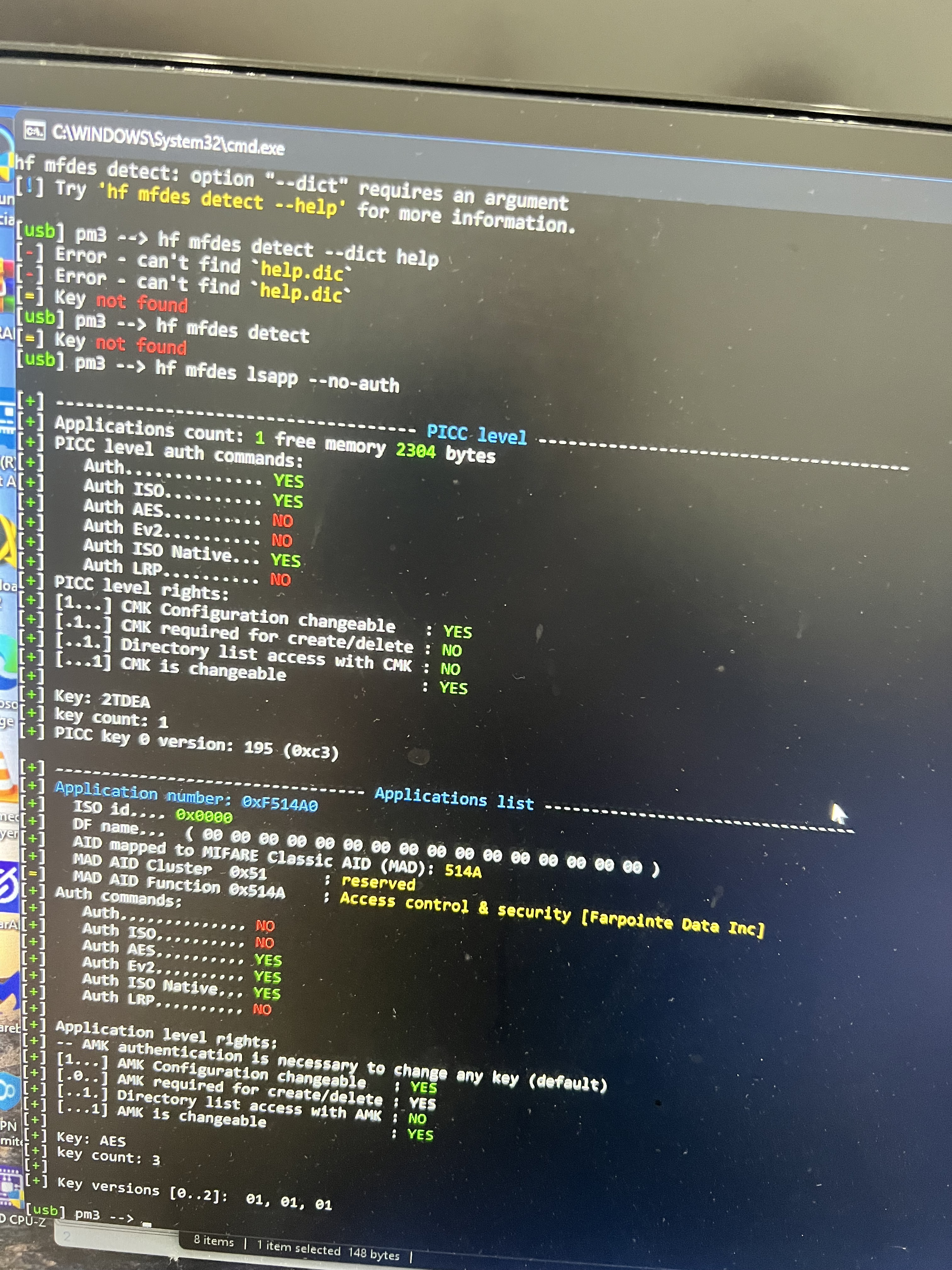

Here’s what I got on proxmark3
What does the key part mean? Did find the key?
If you are talking about the public key section, then kind of in a way, but not how you are thinking.
There is both a public and private key. The public key is ‘safe’ for any party to have, as the private key is what is needed to obtain any real data. The public key in this case can likely only encrypt data, not decrypt it.
Let me reiterate what Amal has already said. DESFire can not be cloned. The encryption and technology used there is insanely difficult to break without the help of a supercomputer and many thousands of dollars of electricity.
