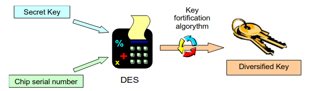

So if we’re looking at this diagram from the datasheet, the “secret key” would be the same key as --ki, and the “diversified key” is the same key which is output by calcnewkey and stored on the card itself?
And it’s that “secret key” which is “hardened” in various ways in SE/Elite systems? Or do they use an entirely different authentication mechanism?
