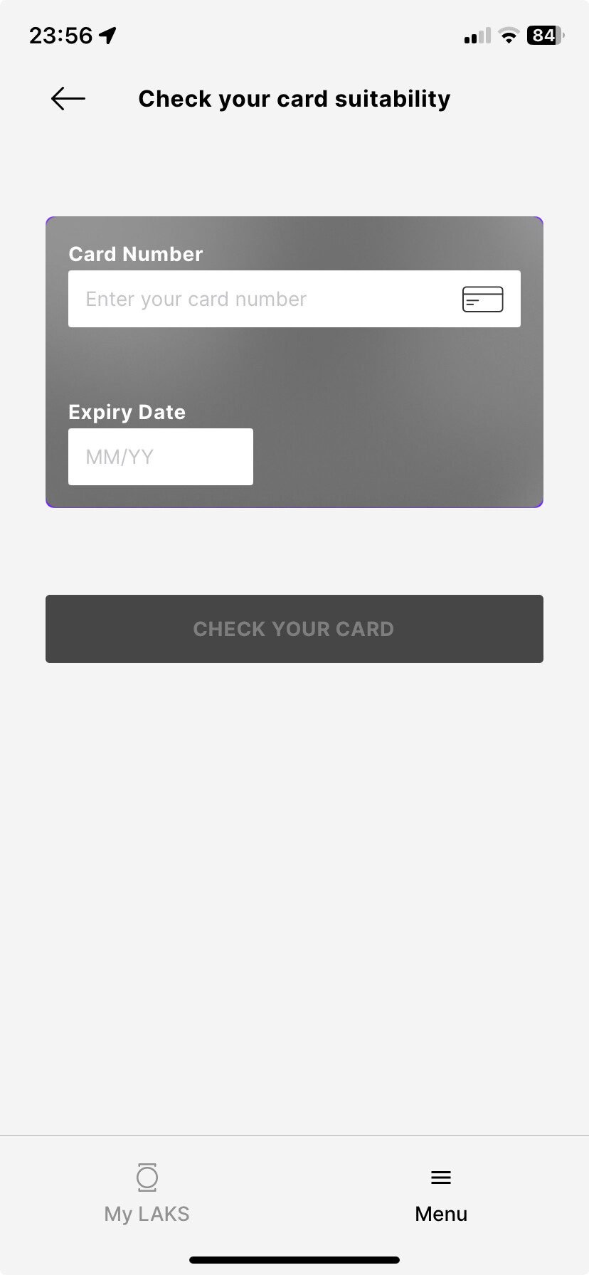

First of all, i checked that my Bank is supported by Laks App, so its ok! supported!
