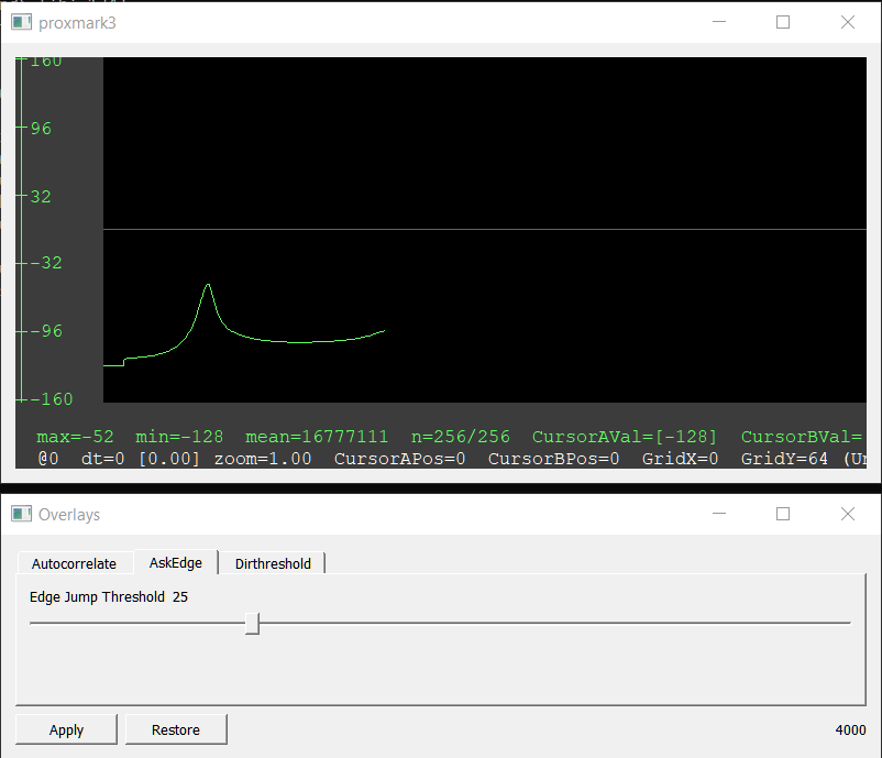

So, when I do lf tune i see IT ↓
[usb] pm3 → lf tune

When I do hf tune I see this ↓
When I do hw tune I see this ↓
So the point of lf tune is to show the voltage levels over time through constant sampling, and you watch those levels as you present a tag… you should see them dip down as the tag begins to couple with the LF antenna. At some point there will be a maximum drop… and this indicates the best position and orientation you have presented the chip to the antenna at (so far)… look for the maximum voltage drop and once you find that position with your chip, try to run commands with your chip held in exactly that position.
The output you get from lf tune looks like I would expect from lf help. I suspect some sort of hidden character in that tune, but if that is all you get then double check your Proxmark3 setup… Possibly even wipe and reinstall.
