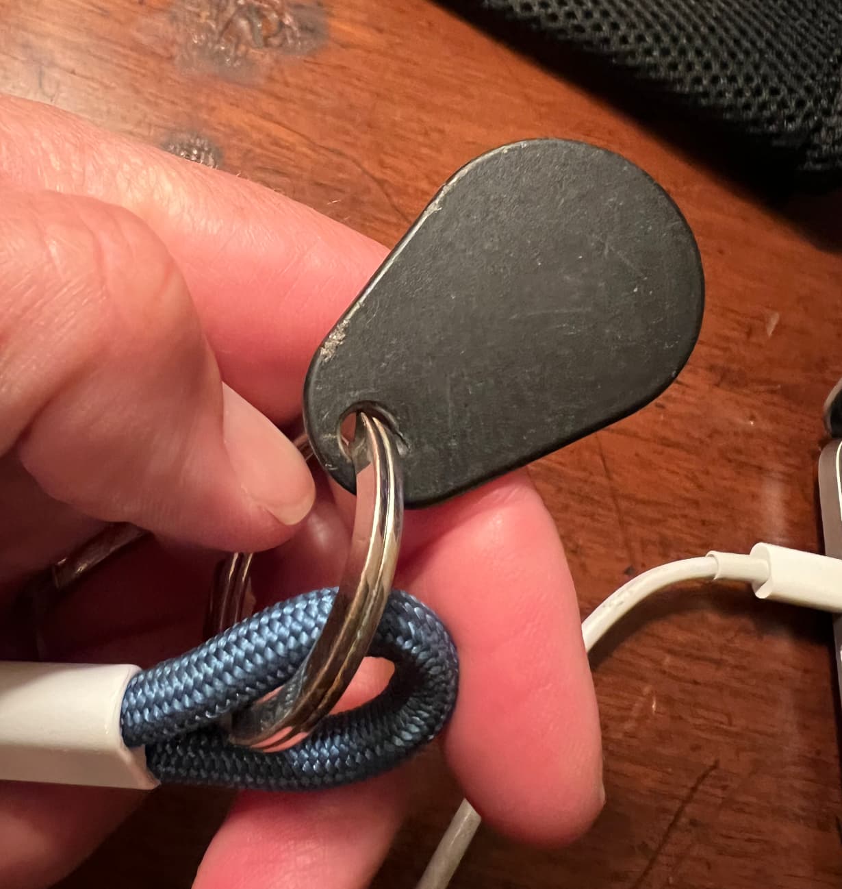

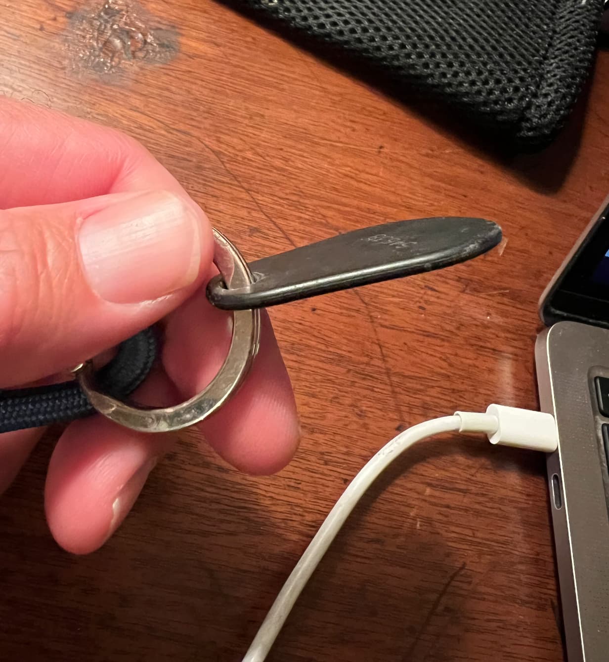

Hi I am new to this world so this is prob a newb question but I have a few questions regarding whether a Proxmark3 Easy from DT vs a Proxmark3 RVD4 from HW is the right tool to solve my problem which is to copy a Mifare Classic 1K fob (I think? photos below).
After sifting thru the internet I can’t find the exact answers and it seems like this community has a lot of knowledge. Here is my question let me know if anyone can help:
I was trying to copy the Fob in this photo below with my flipper zero

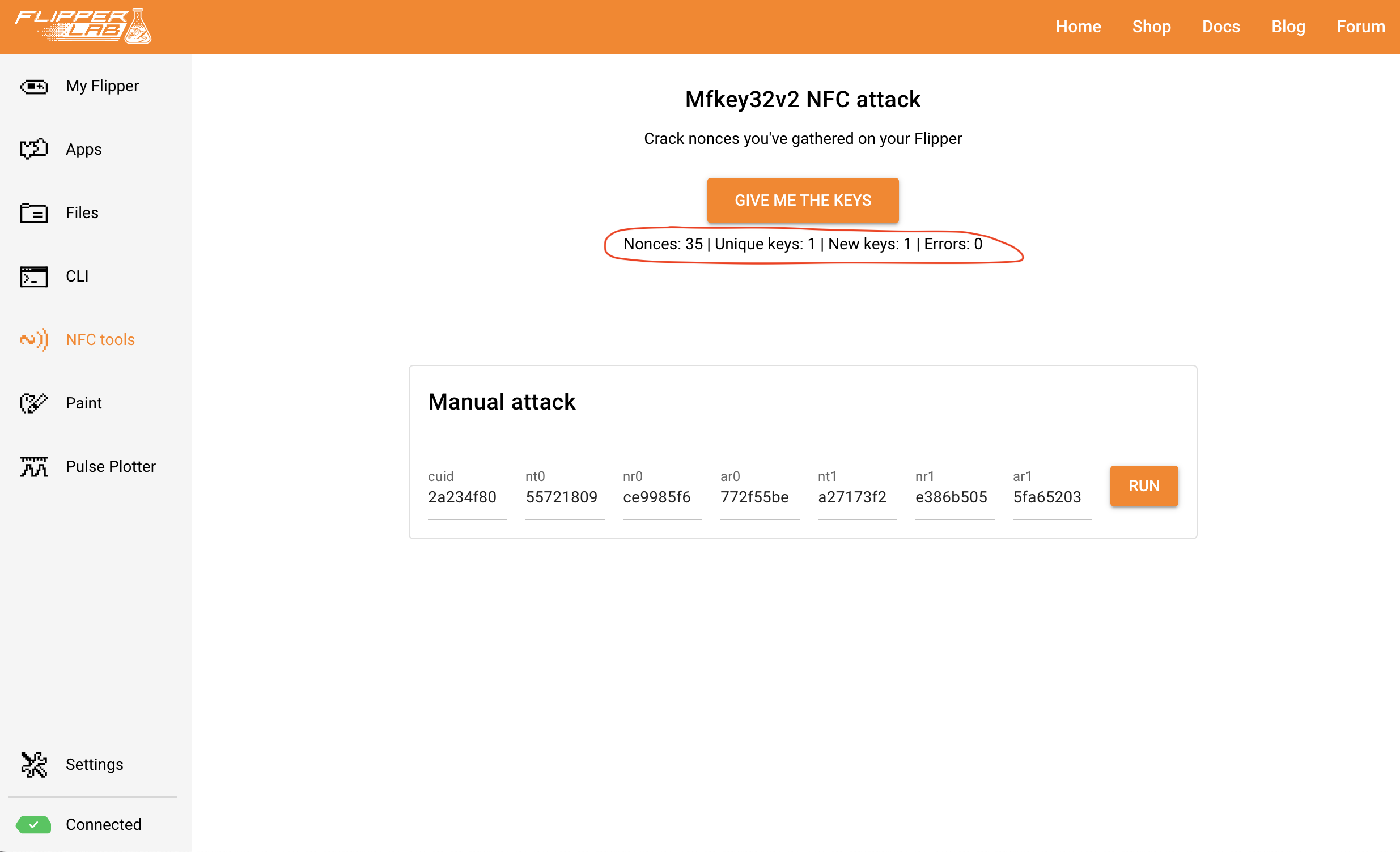

Here is what I got back with Flipper with updated Momentum firmware.
I first read the card/fob using the flipper Nfc “read” feature and then went to the saved file and used the “extract MF Keys” and tapped the flipper up against the actual reader (see photo below) which said it read nonces.
Then I ran the MFKey feature and here is what I got back:

I have the .nfc file pasted above and after running the MFkey I got the below info after running the “manual attack” (see screenshot):

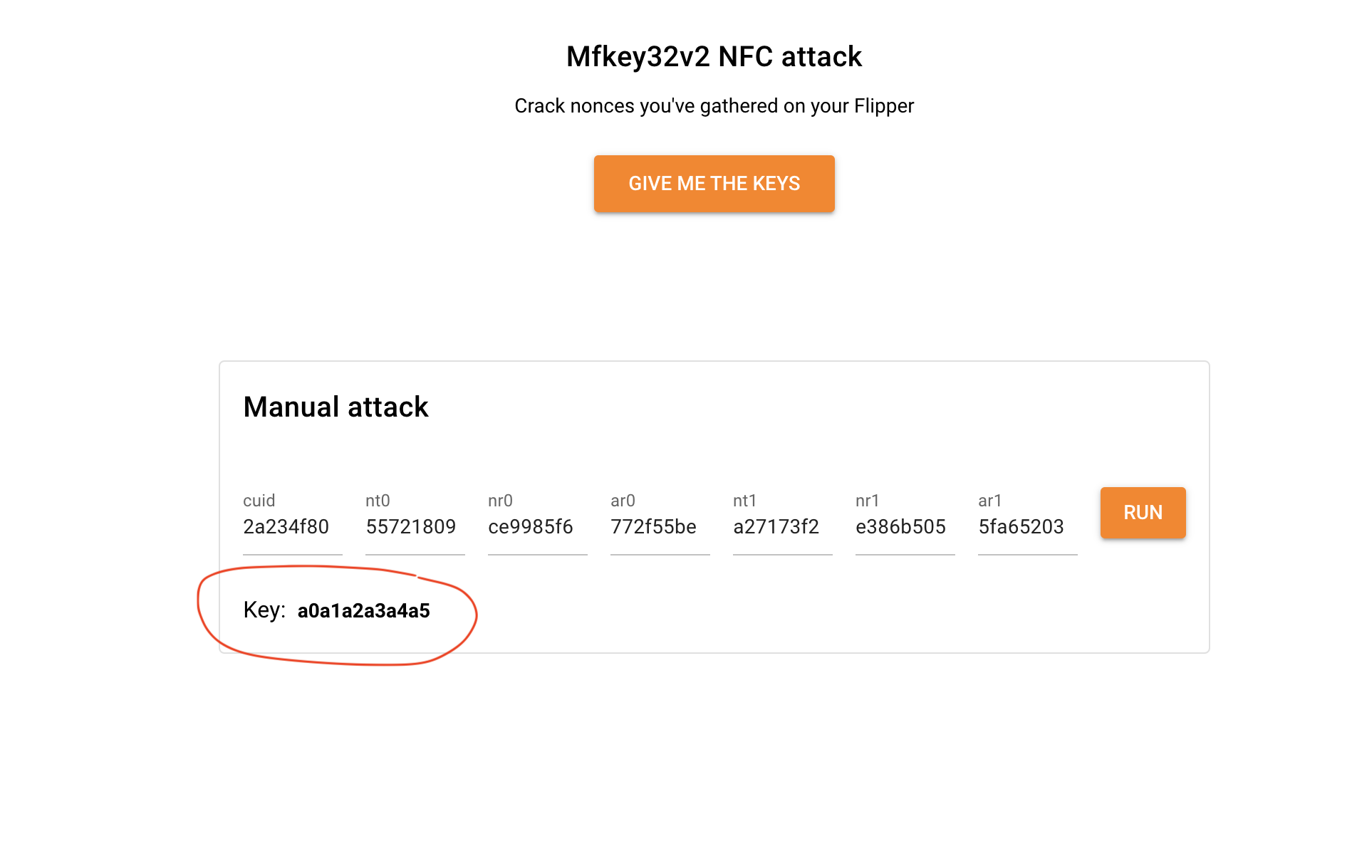

And then I got the below after running “give me the keys”:
Then I attempted to Read the card again to see if it had any more sectors or keys available and it was still:
Keys Found: 28/32
Sectors Read: 14/16
Let me know if this is as far as the flipper can take me with this specific key? If so I am willing to buy the Proxmark3 to crack this thing–just want to make sure it can be done using the Proxmark3
Any advice greatly appreciated!
