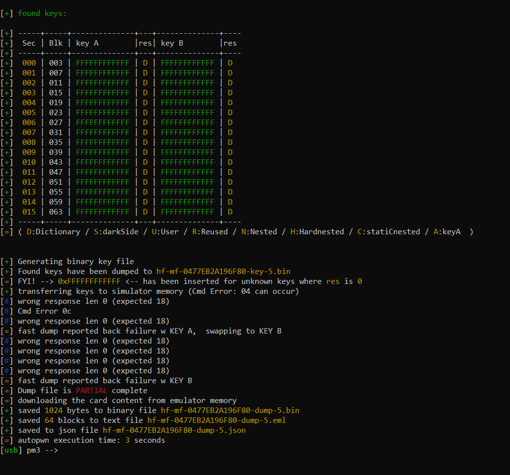

my first step I did
hf mf autopwn
Then I typed
hf mf cload -f hf-mf00477EB2A196F80-dump-5.eml

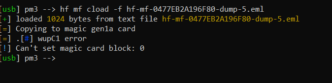

I am getting this error after typing the code, do you happen to know what I am missing?
Screenshot_7
you need tohave a key file for the magic card, autopwn it
