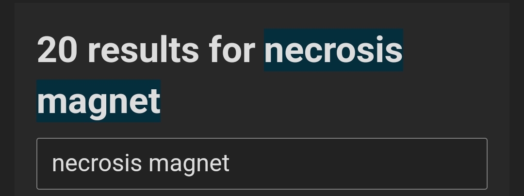

There’s a thread here somewhere about not keeping things attached to the magnet can it can cause death of the skin because it limits bloodflow in that area.
Yes indeedy
if you search for
Sounds like an evil spell from AD&D

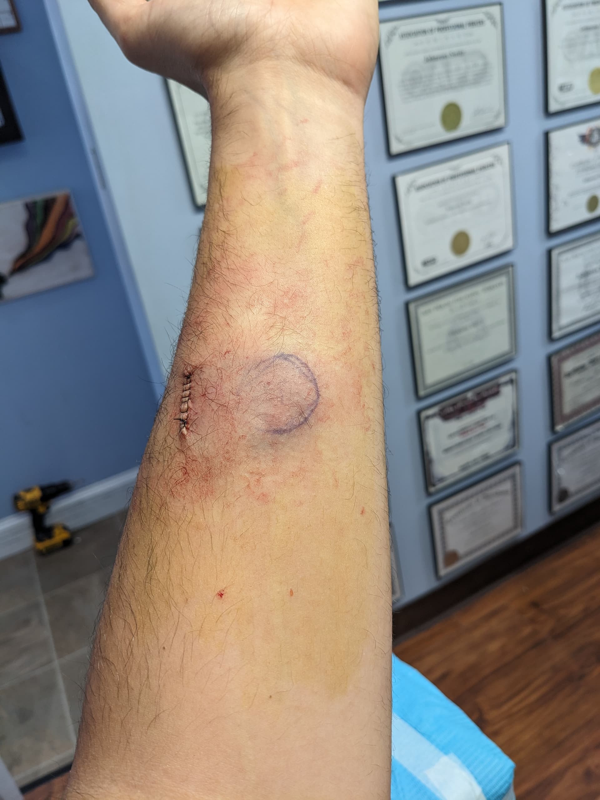

I had this magnet implanted in my arm. It has two crescent shaped magnets inside that are opposite polarity. With a careful mounting plate setup I can adjust the padding, thickness, and magnet strengths to dial in an ideal pull strength that will keep the electronics on my body, but distribute the force enough not to cause tissue necrosis (taking it off at night).
Is that a piece from an actual cochlear implant setup?
I’m assuming you didn’t attach directly to bone like a real deal cochlear is done…
I have so many questions…

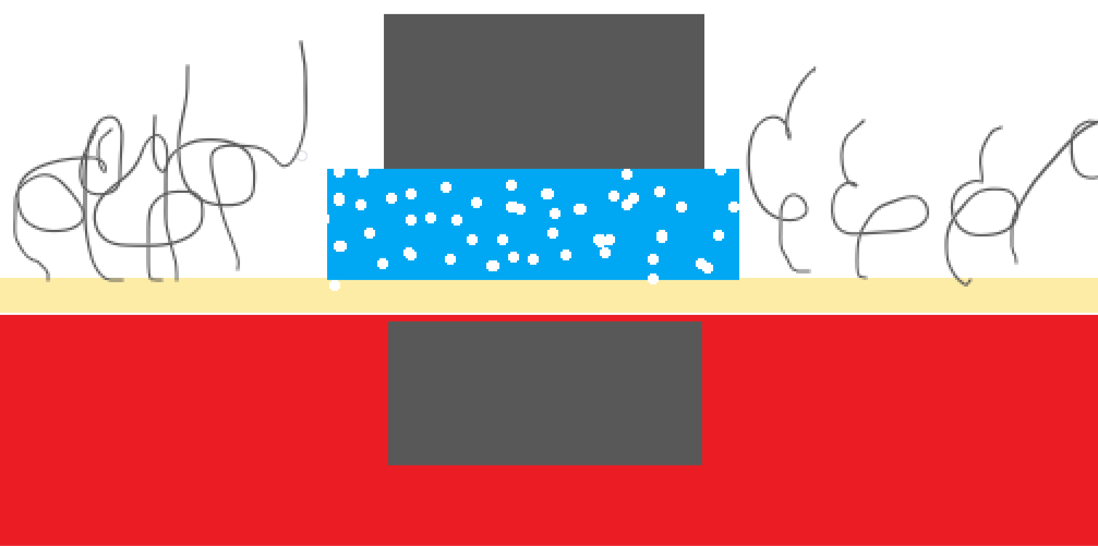

But if you put a thin layer of foam between the skin and the (external) magnet, wouldn’t that prevent blood flow from being blocked?

Yeah, it’s medical surplus. I didn’t attach it to bone because that’s a lot of work and I didn’t think it was necessary. I want to test this out for viability and if I get too fancy other people won’t be able to replicate it. I actually cut the bone mount section off since it was protruding.
Part of the problem is that the blood vessels are being crushed from the inside as well as the outside. The padding would help, but with such a small magnet the pressure will still be concentrated in such a small area that you’ll encounter issues. It’s a delicate balance between how much strength you want, and how long you want to be able to wear the device before you start damaging tissue. You could always do thicker and thicker padding until it’s fine, but it will likely fall off. That’s why I wanted to start with as large a magnet area as possible, and make sure the exterior mounting plate has padding and it’s even larger.

The problem here is force. The amount of force you need from the magnet to effectively stick the device to your skin is the same amount of force that will restrict blood flow. If you put a bunch of stuff between the magnet and the device, there won’t be enough to hold the device to the magnet / skin. You can’t have something that is unequivocally stuck to your body without the required force to keep it there.

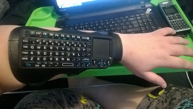

I got a phone strap holder to do exactly that …
i have this exact keyboard and one with a large touch pads, its awesome for large presentations :+1:
I have that one also, use to use it when I was production… far easier than using (shitty) touchscreen using on screen keyboard
