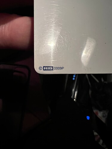

My work badge is HID.

The LF side of the NeXT can probably clone your HID card (unless it is something strange) you will also need a proxmark3 easy to actually read and copy low frequency chips. (Ok there are other ways but trust me you will want a pm3)
You can also use the pm3 for NFC, but if that is all you are interested in your phone probably works.
I’m going to be getting a proxmark3 in a couple of weeks probably right before or after I get the chip installed. I have an iPhone 13 pro max my phone will not pick up on my HID work ID.
That is actually good news as it means that your work ID is almost definitely LF only.
The T5577 chip used for the LF side of the NeXT is capable of cloning an HID chip.

it could be iClass :slight_smile:
Could also be mifare classic, and the phone isn’t compatible… say iPhone
Not particularly likely in his instance

You definitely will be able to clone your work badge. I have the same exact one. Took me about 30 seconds to clone it. Kinda freaky tbh.
