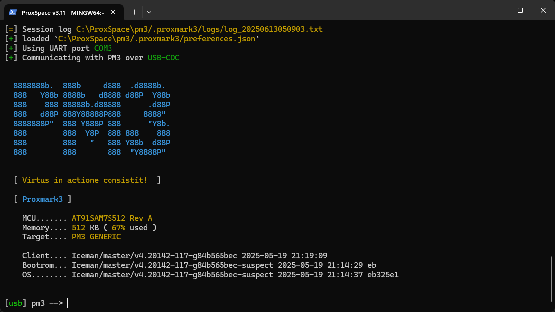

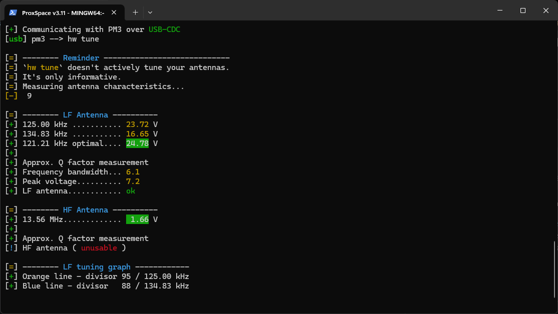

my implant is reading much better now and i’ve been able to set up the lf side for a weigand hid fob, as well as setting up the hf side for an nfc tag, but i’m still having trouble with the proxmark3. I got a booster board, but after i installed it, hw tune is saying that the hf antenna is unusable. it still works with the original antenna though. my friend has one as well with a booster and that one also said unusable. switched it back to the original antenna and it works again. any advice?
screenshot of hw tune and firmware versions attached

The problem is that the firmware code that analyzes the antenna performance is not designed to accommodate the booster board, so it gets erroneous readings. A similar effect would happen if you placed a transponder on the antenna when trying to get tuning data.
was just about to update, I didn’t realize that the hw tune would fail with the booster board and it seems to be working fine
We’ll put a better notice on the booster board product page about this… but it’s important to also point out that hw tune does not “tune” the antennas… it does not change or adjust performance at all, it simply tells you the performance characteristics of the antennas installed. Because some models can swap out or literally switch (with a small switch) antenna characteristics, this is an important firmware feature… but also open source hardware being mass manufactured by a maelstrom of faceless unknown factories across China means they (and you) need a solid way to verify performance of these notoriously picky components, particularly in troubleshooting situations.
