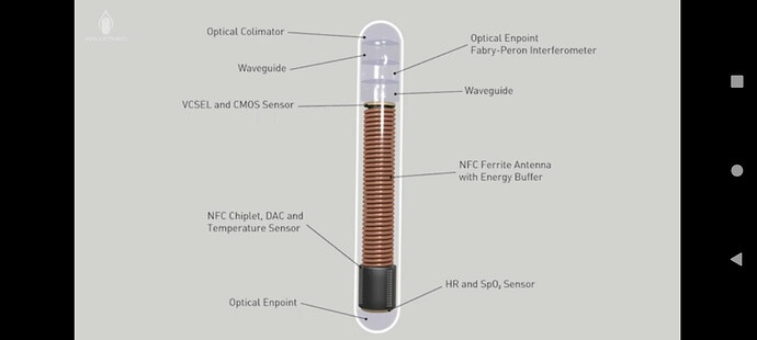

What is this? Never heard of it…
Can’t find much info online other than Wojtek Paprota has something to do with it…
I can’t tell if this is a realistic thing. What’s an energy buffer? A capacitor inside the coil?
How much energy do all these sensors need ?
If this is not a troll or scam then it’s a serious competitor to beUno. And competition brings innovation so… Good?
Also, what’s the feasibility of turning the tip of a glassie into a lens?
They would have to be custom-made and it looks like there are sensors on both ends so how do you seal the capsule cleanly enough to create the second lens?
How useful is a temperature sensor in the hand?

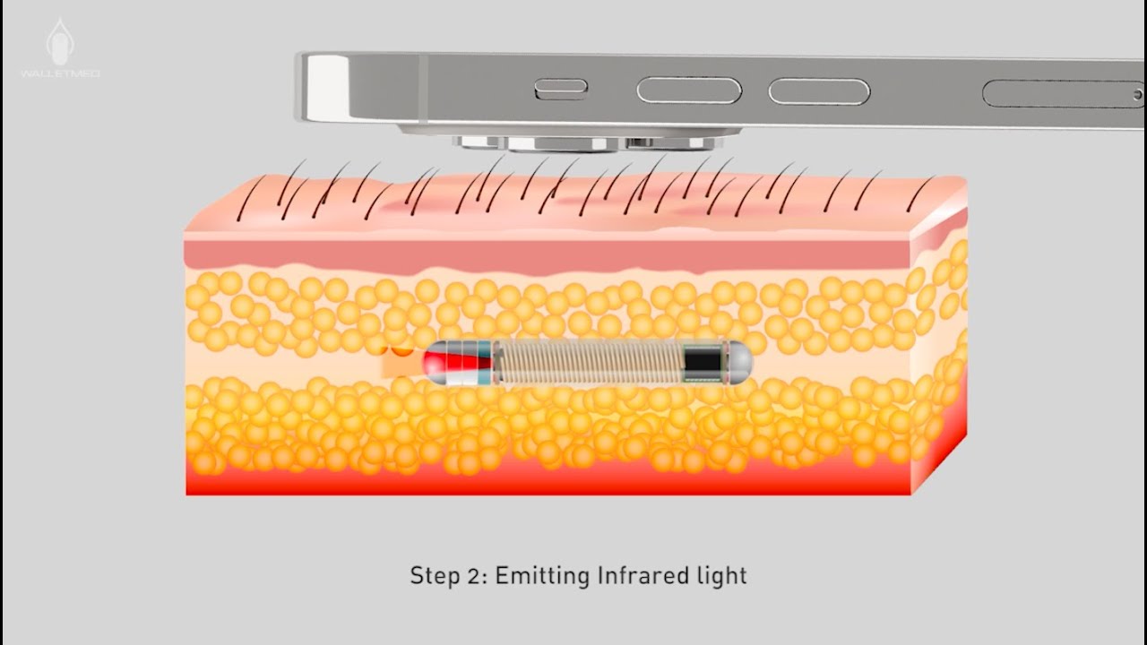

There’s a lot of technical hurdles they need to overcome, but I think it’s possible. Biggest issues are going to be form factor of the available components to fit in glass and the power budget. An interferometer could do the job, but it’s likely a laser diode which is more power hungry and larger than a conventional LED. The end of the glass being used as a lense is also a big issue. They’ll have to use the presealed end, and even then consistency will be a huge issue. They may need to integrate an actual lense made of optical glass into the construction, and the glass-glass interface may introduce biofouling issues.

It seems like they do in the video and that was my main concern honestly. For this, the power and the size of the components I feel like this would be at least the size of an xG3
Honestly with a small cylindrical antenna that’s 2mm diameter you’d be lucky to get 30mA at 3.1V. I think they’re going to need to size up to 4mm glass.
I feel like this is going to become a chest implant rather than a hand one like it’s advertised in the video. First for the size and second to give some relevance to the thermal sensor. It just seems more reasonable for this design.
