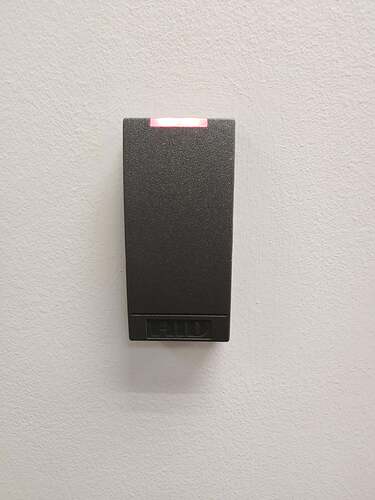

Could you upload an image of the reader?
I had tried to use my xNT, however it doesn’t seem to scan (or at least the scanner doesn’t make a sound). For more info, I can also not scan my card on my phone (LG V40) so I don’t know what that means. Here is a photo of the reader

These HID readers you may have a couple of options, but you are likely limited…
Ignore your issued tag being ISO15693 - the only ISO15693 card type is supports is a HID programmed PicoPass which isn’t available as an implant.
The readers at a hardware level also support all ISO14443a cards, but this is a setting that can be enabled or disabled on the reader. The best security option is that it’s turned off (bad news for cyborgs), next best that that it’ll accept a Mifare Classic with custom HID programming (alright news for cyborgs if you can get a data packet correct), or better again is that its on in UID only mode and literally any ISO14443a tag that couples with the reader can work (unlikely usually, don’t usually see this in the wild on big installs)
Babak has a talk on YouTube on credential downgrade attacks - figuring out the Wiegand data that’s outputted on scanning your real card and using another card type with programming that will produce that same output. I’m not that well versed in it, but I believe the limiting factor comes down to legacy modes being enabled on the door still - so a MultiClass reader with LF/Legacy HID Prox II turned off isnt a good candidate for this, but may be viable.
