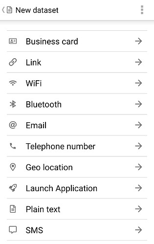

NFC so you can “talk” to it with your phone
NDEF NFC Data Exchange Format (NDEF) allows you to write things such as these to your chip ( upto a maximum size of ~ 888 bytes.
using an app such as TagWriter by NXP
