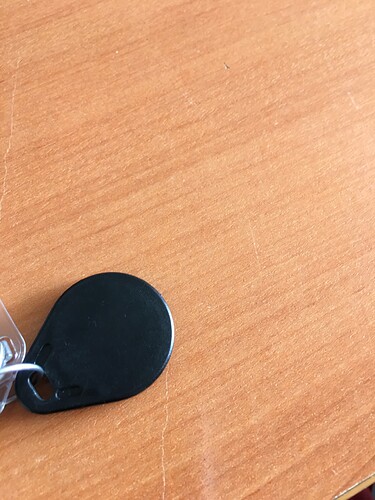

Also, the black fob.
Are you able to easily (non destructively) open it up?
The chip may have letters and numbers that will give some clues, and also the antenna size and shape.
