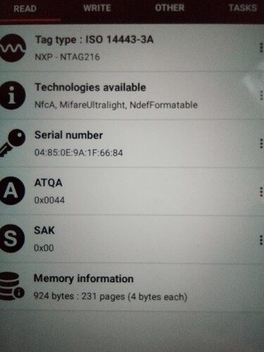

Not exactly sure what I did. I can’t write to it with my phone and when I scan it only comes up with this info and no longer has the password protected column or read only
Can you try doing a full scan with taginfo and posting the xml or txt file here?
Damn so I blocked it
Why do you say that? Looks fine to me. The first memory page got wrecked to all nulls so you borked the NDEF record but that’s easy to fix.

Hmm no ndef detected result: this tag can’t be formated parts of tag protected
Yeah that’s what it says…but it’s just… wrong hahah
This is exactly the same issue. Basically even NXP, the makers of this chip, don’t properly parse the lock bits according to the standard… they just see that something is set and give up. Lazy assholes.

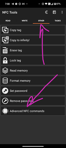

Search for NFC Shell to fix… you basically have to hand write the memory blocks to a blank record to fix at this point…

Sideload this… if you can… otherwise use the advanced NFC thingy in NFC Tools…
