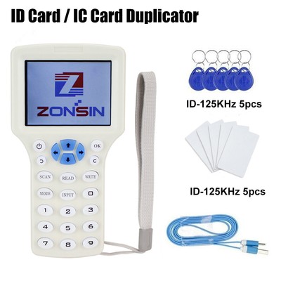

I originally set it by copying the values from a tester RFID car, and writing using this device
https://www.ebay.com/itm/M1-Key-Tags-Copier-Reader-Writer-ID-IC-Card-Cloner-RFID-Duplicator-Programmer/123747379395?hash=item1ccfeb28c3:m:m5TdA54BdHM7NFBYZ8Qm31A
Yeah these cloners can set up some really crappy outcomes. You may now need to invest in a proxmark3 rdv4 and the ProxLF antenna dngr.us/proxlf to fix this.
@tomharkness has done a lot of work in this area. Search the forum for his posts.
