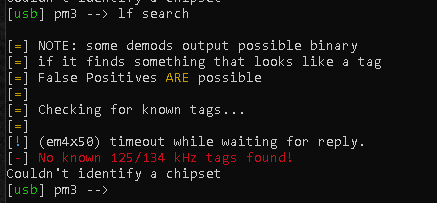

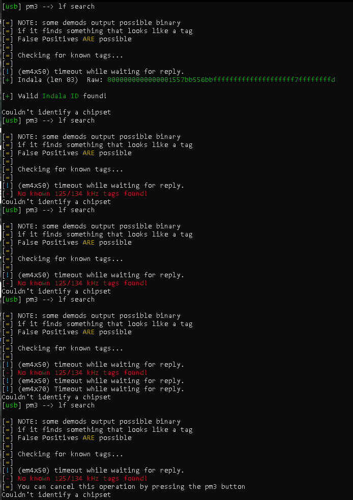

But the 125Khz side can´t be read with the proxmark3 rdv4 with the antenna from DT, does anyone have the same problem?
i tried several times and only one time i get info about the chip (indala)
i know that the reader is working because it can read my other implant in the right hand.
Perhaps it’s not getting a good strong couple.

no :frowning: sadly im still getting the same error:

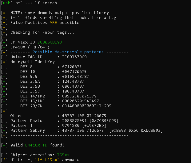

Did the tuning trick.show significant changes during positioning? If so, you might just attempt to relocate the maximum drop position again and then issue a write like
lf em 410x clone --id 0102030405
Send that a few times and then do a search
No, the 27620 mV only moves to 27500-520 and 27620.
I had this problem in the beginning as well. I just kept moving the antenna around until I found the “sweet” spot. Took me a while but I can consistently get a read/write on it now.
