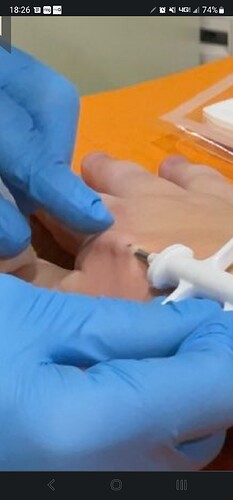

I got my NExT implant a week ago and I ran into a little problem.
I asked for the implant in my right hand, it was put in by a body modification artist I found on walletmor.

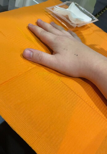

Position:

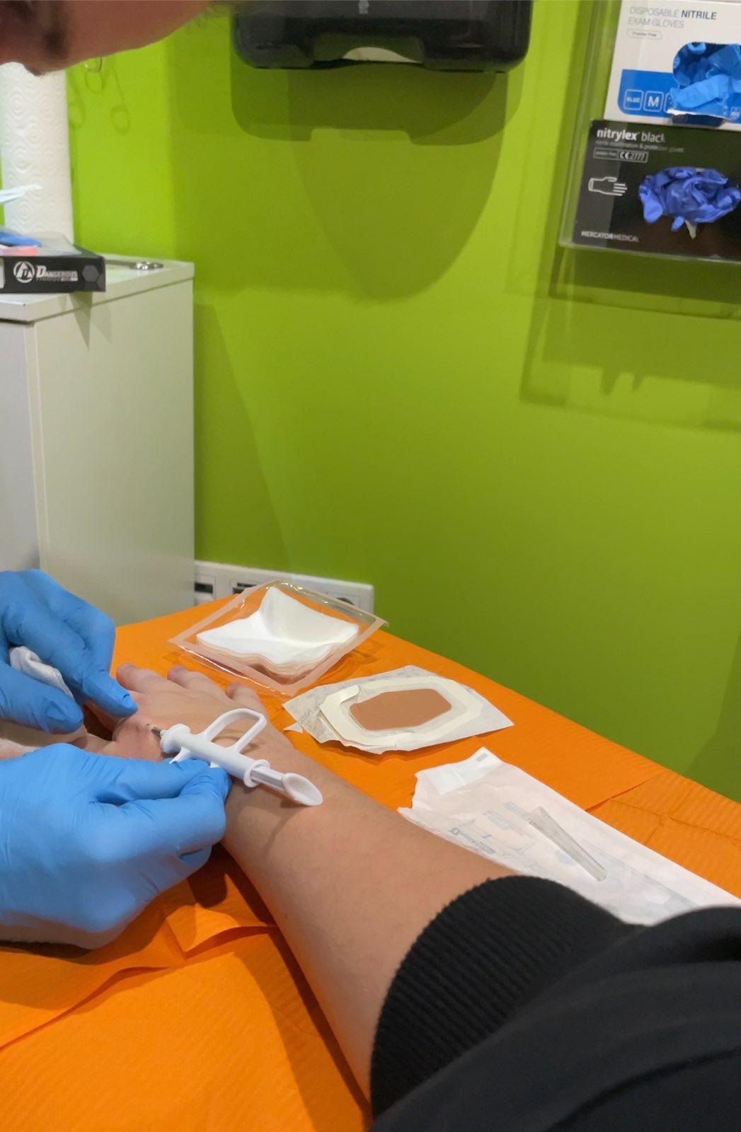

Installation:

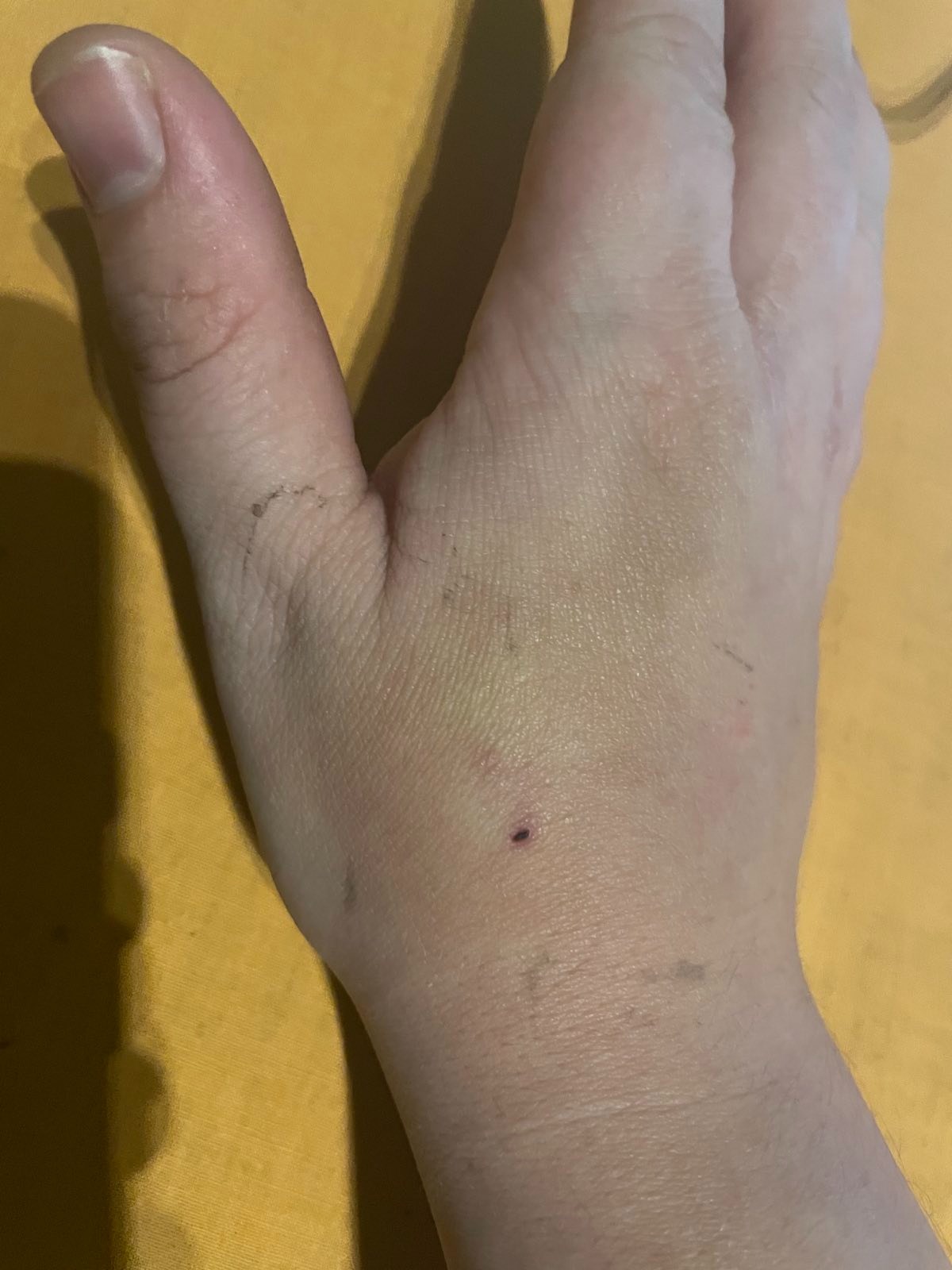

My hand after the procedure:

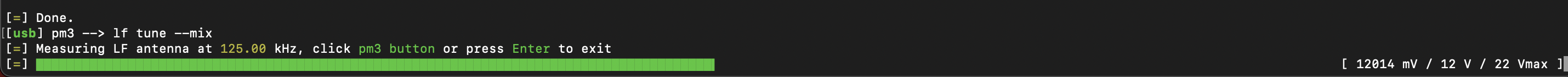

Everything went fine, but at the moment I can only scan the implant with flipper zero alone. I also have a proxmark3 easy device, but it does not see it in HF or LF mode. I was able to successfully clone one of my EM4100 access cards with the flipper, but the access control system cannot read it either.
Proxmark3 Easy LF antenna tune result:
Is it possible that I got the implant too deep? What can I do in this case besides removing it?
Thanks in advance for any advice.
give it at least another week to properly heal before considering removal
Looks a good depth for me.
Getting a reading with the proxmark is tricky.
Patience. One of mine took about two weeks. The other took just over three weeks. Whatever you do, do not try to write to it until you get consistent reads.
The flipper has a great antenna system, but it’s software is still growing
the proxmark can do nearly everything possible, but the antenna has a indescribably small sweet spot
Also post install swelling effects read quite a bit; yes you are swollen even if you can’t see it lol
Welcome to the club, give it a couple weeks
If the flipper can read it, your probably fine, just swollen and the proxmark is a pain
Search around the forum, you can use “lf tune” to find the highest voltage drop, and that should be pretty close to sweet spot

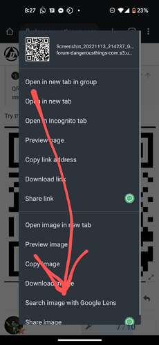

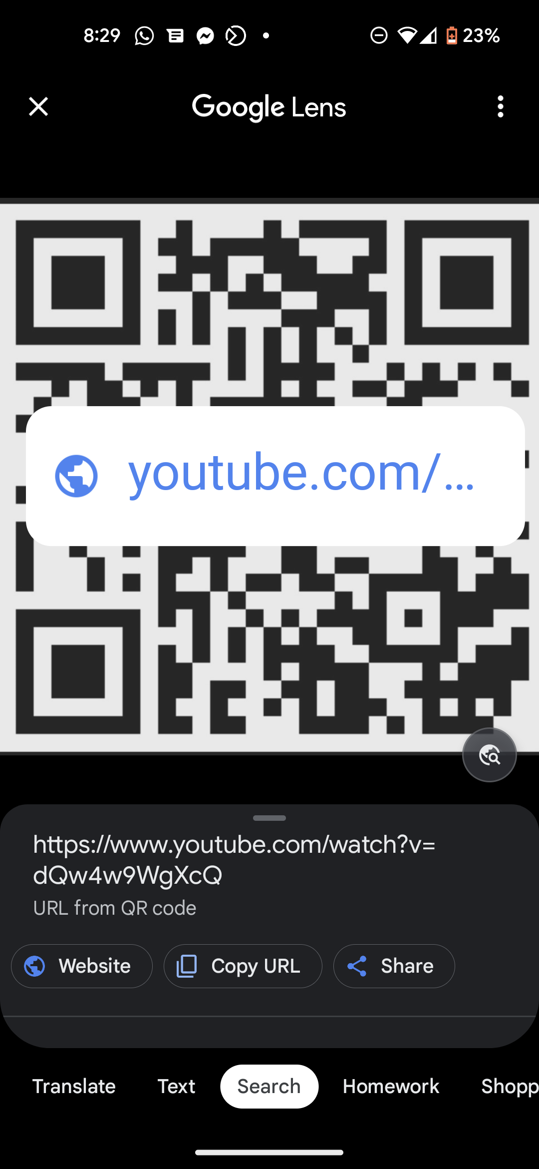

Nevermind… this works… just hold the qr code… then choose Google lens
It will decipher it for you.
