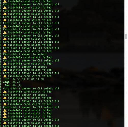

I think I finally got a read. Just seems to be too deep?

Rather than cycling through the hf card types for a very short period of time when we know what the card type is I have used multiple ‘hf 14a reader’ and ‘hf 14a cuids -n 500’ to make multiple read attempts of the tag allowing time to slide the antenna around etc.
With this I get the very occasional read.
My conclusion that the the chip is just too deep in my hand…
