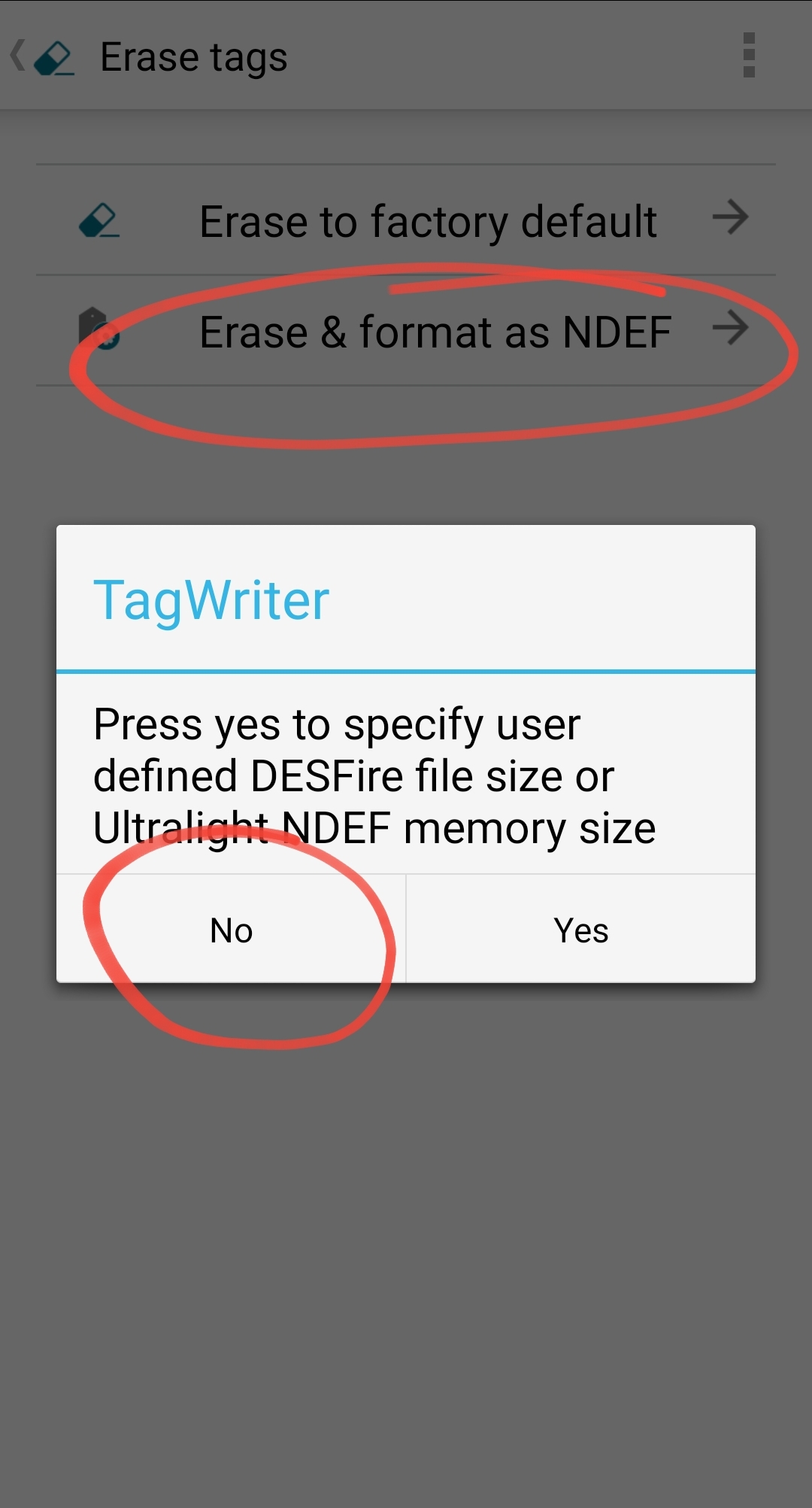

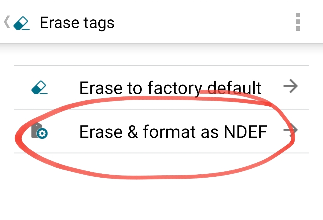

Used another phone and was able to read, erase and then format the NFC chip. I am now able to read the card with my original phone, though it does say password protected, but that’s a problem for another time.
