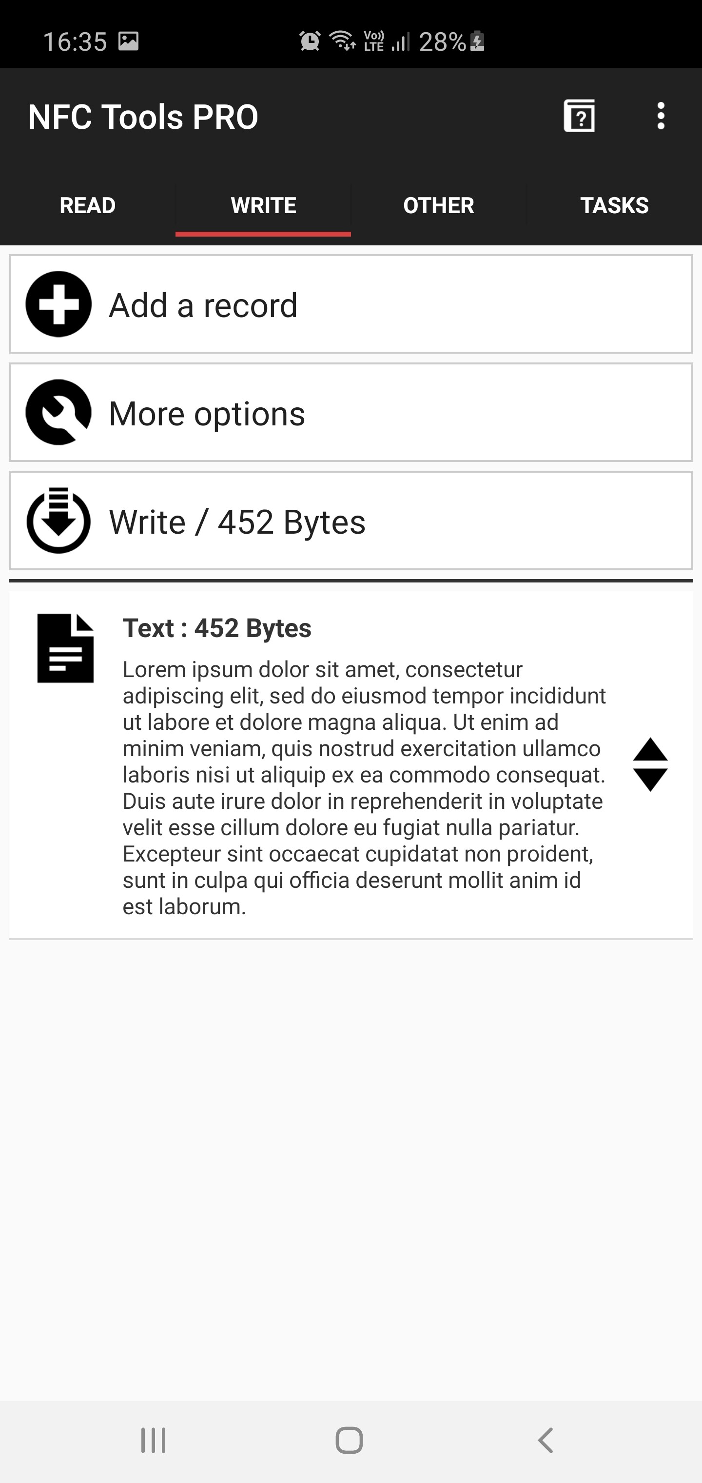

Right so let’s use NFC Tools.
Head to this page and select “erase tag”
Head over to the write page add a text record
Lorem ipsum dolor sit amet, consectetur adipiscing elit, sed do eiusmod tempor incididunt ut labore et dolore magna aliqua. Ut enim ad minim veniam, quis nostrud exercitation ullamco laboris nisi ut aliquip ex ea commodo consequat. Duis aute irure dolor in reprehenderit in voluptate velit esse cillum dolore eu fugiat nulla pariatur. Excepteur sint occaecat cupidatat non proident, sunt in culpa qui officia deserunt mollit anim id est laborum.
Then read it and let’s see what we get.
Hopefully something like this

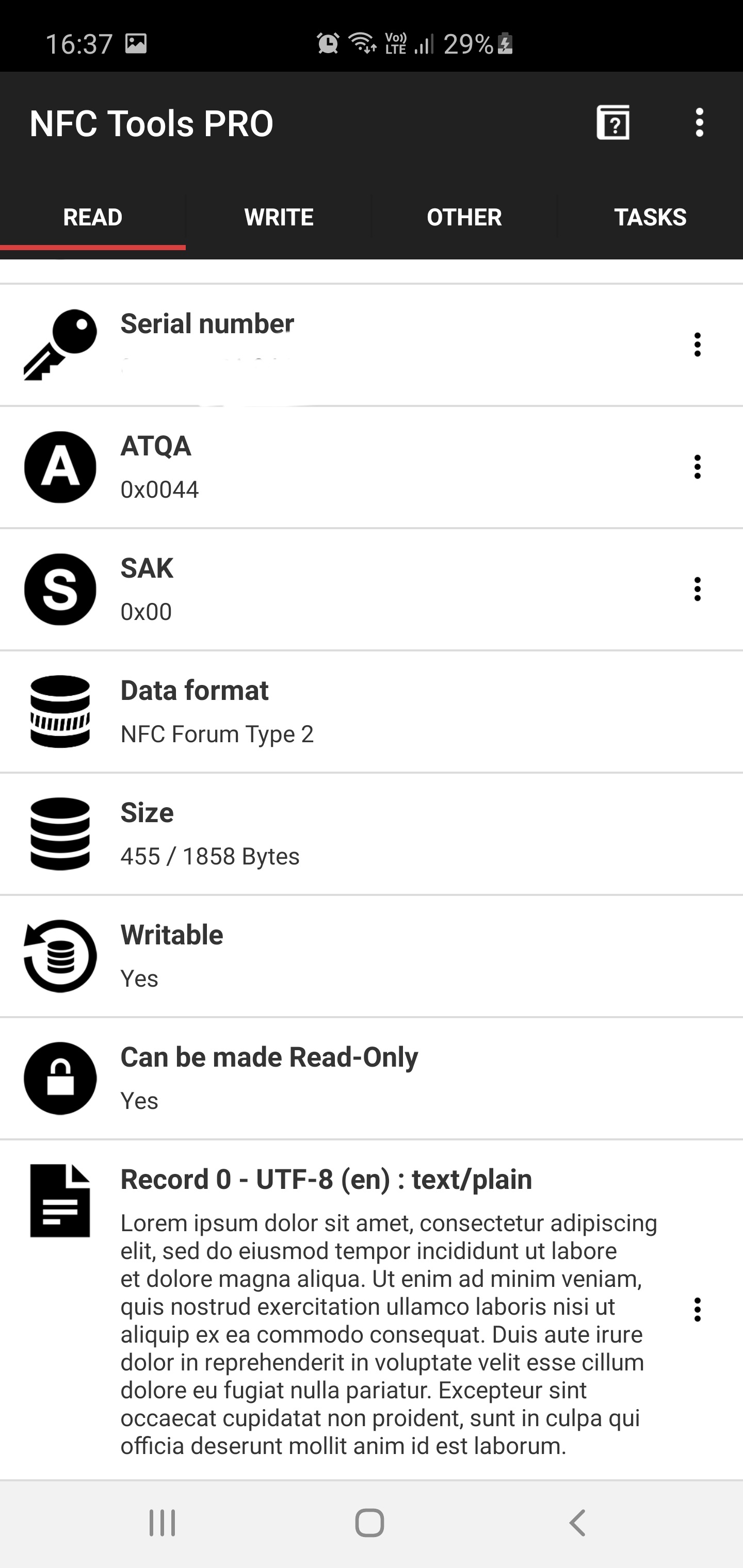

Huh yeah that works, 676/820 bytes. Why is it saying the tag is too small for a contact card then?
Granted that was in a different app, NFC Tools Pro doesn’t let me just write a vcard from my contact list, which is why I was trying some other way…
Though I suppose I can just save it in NFC Tools Pro instead.

Where you trying to use NXP tag writer? That app is seriously broken at the moment
As I wrote above, the details are a bit fuzzy atm, like I said I’ve been sitting on this “issue” for a while.
I THINK it was trigger writer, which… I have no idea why I was using that now in retrospect.
I DID just try with NXP Tag writer and it seemed to write a contact just fine?
Have I really been sitting here thinking it was fucky somehow and it was just the app the entire time? I feel like I tested more than one way at the time. Hard to say, was a while since I actually got off my ass with it.
The main thing is that it works :slight_smile:
