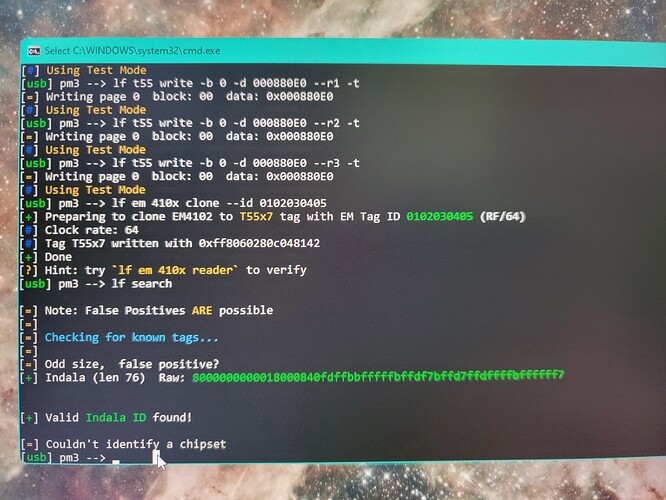

Hmm unfortunately this isn’t looking great. Can you position the proxmark3 in the best place you can based on the tune work, then try these steps;
After countless attempts at that process this is the best output i could get from lf search
Unfortunately indala reads like that are almost always a false positive

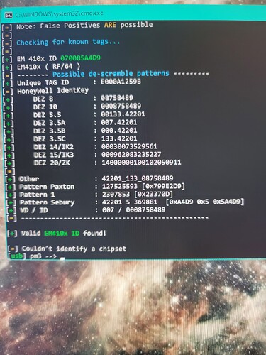

Ill keep trying that revival method from earlier and hope for the time being
Yeah this is because they are huge diameter antenna coils compared the the very small loop coil antenna used in the implant. Coupling is much more difficult for the implants vs keyfobs and cards.
