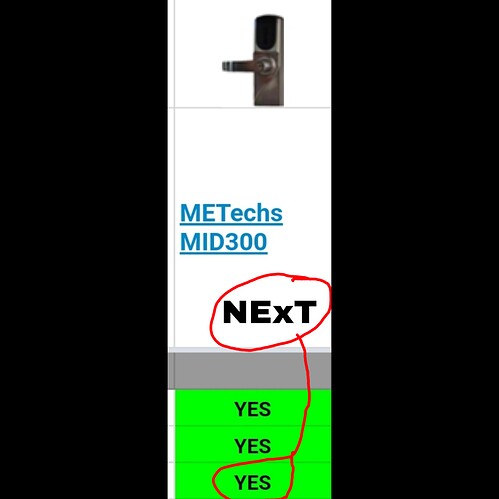

I bought this door handle to use with my NExT and it shows that the two are compatible but the lock doesn’t read my implant. It reads other fobs just fine though. Am I doing something wrong?
I know I should go take a look at that lock in the compatibility matrix to figure this out but I’m mobile at the moment and somewhat distracted.
My question is, does this lock use the 125 kHz fobs or 13.56MHz side of the NExT? If it is 125 kHz, have you programmed the t5577 chip in your next implant to be something else? Like maybe an HID prox?
Also have you used the field detector keychain to figure out the correct location and orientation to present your implant to the lock with? That could be the other issue is that sufficient coupling with this lock is not occurring.

I just checked with the detector and it didn’t find anything. Does that indicate that my implant won’t work with this model? I bought the door handle directly from the link on the Compatibility Matrix
That is a good indicator that you may well struggle.

As mentioned above, that was direct from a very old post (2016) and unfortunately, when manufacturers alter their equipment, it is out of our control.
If you cant get it to work, I hope you can return the lock…Or get a FlexEM
and I will add a note / change the YES to No in the MATRIX
FYI
I put the matrix together using information from community member’s comments and some best guesses (ie. If it works with an xM1 it should work with a FlexM etc) and included links to forum posts where possible for people to research and set realistic expectations.
An xSeries is going to struggle on most battery-powered locks, and even some mains-powered ones.
Even small manufacturing variations can make a big difference.
Sometimes a little hacking may be required ( can the antenna be brought closer to the surface!?)
I have tried to make the matrix as accurate as possible with the information I have, but without testing each and every lock with each and every implant, I can’t personally guarantee it, but I have tried my best to make it as accurate as possible.
Basically, use it as a guide ( pretty accurate guide ) but unfortunately, whilst I cant personally guarantee ALL the information contained within the Matrix it was definitely made to help others and your feedback will do that also, so thanks ![]()
