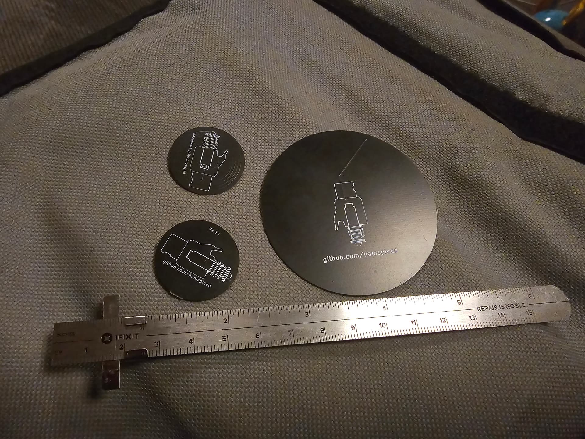

So let me recap how I got interested in his project. As mentioned above, I’ve got a new phone, and with the case I am using the reading range of my implants was horrible. x series were readable when I press my phone to the skin, apex flex was not readable at all. As you can imagine I was not exactly happy. I was keeping an eye on Hamspiced topic for some time, but I was wondering how exactly this will mature in a real product. By this time antenna was a copper coil soldered to the pcb. Fast forward, a month and something ago I’ve contacted him, we had a talk, and after some time I ended up with a package in my mailbox full of goodies.

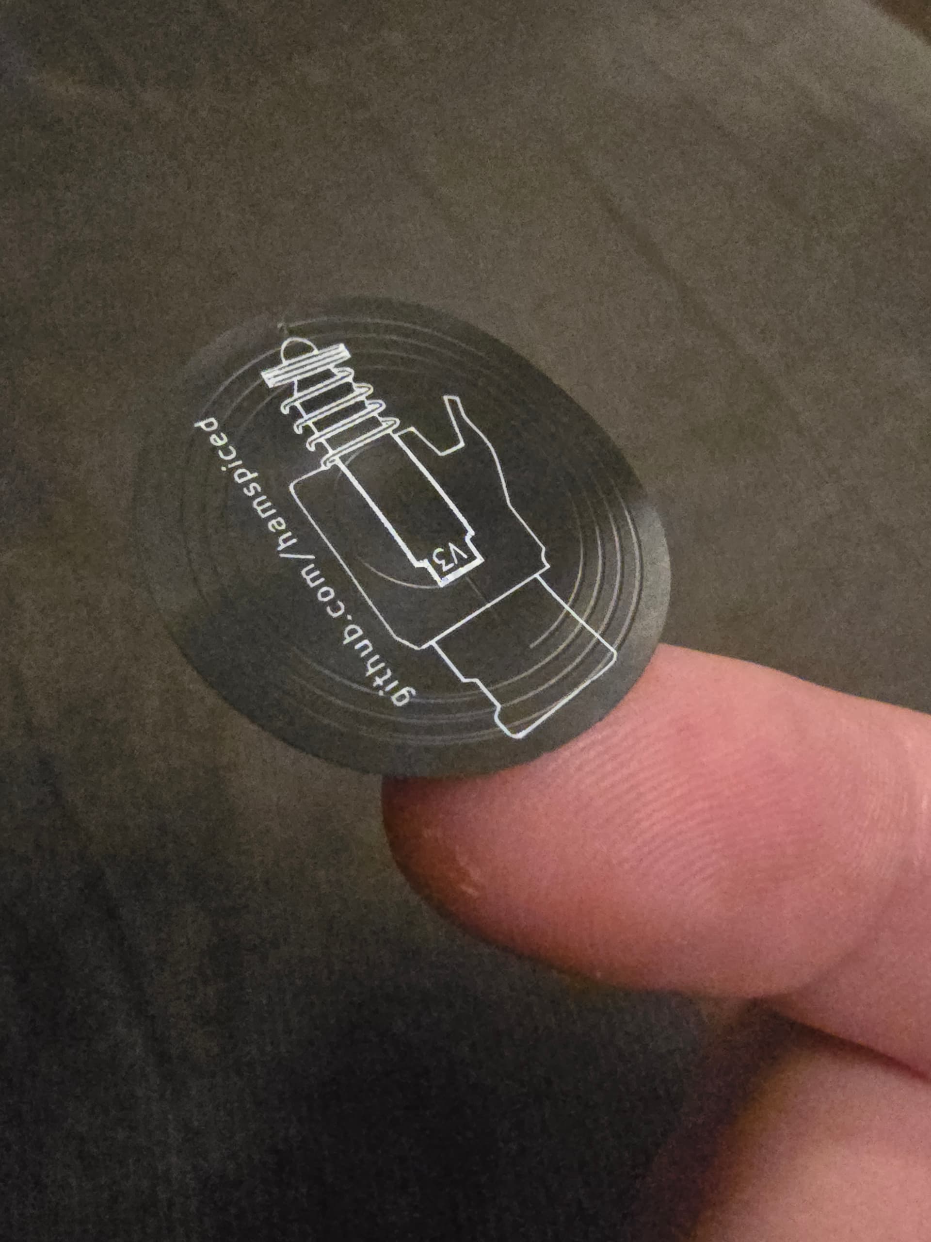

To my great surprise the design evolved even more, so now he actually made a stickers. I do not know how much time he invested into refining this project but the end result is just mind melting.

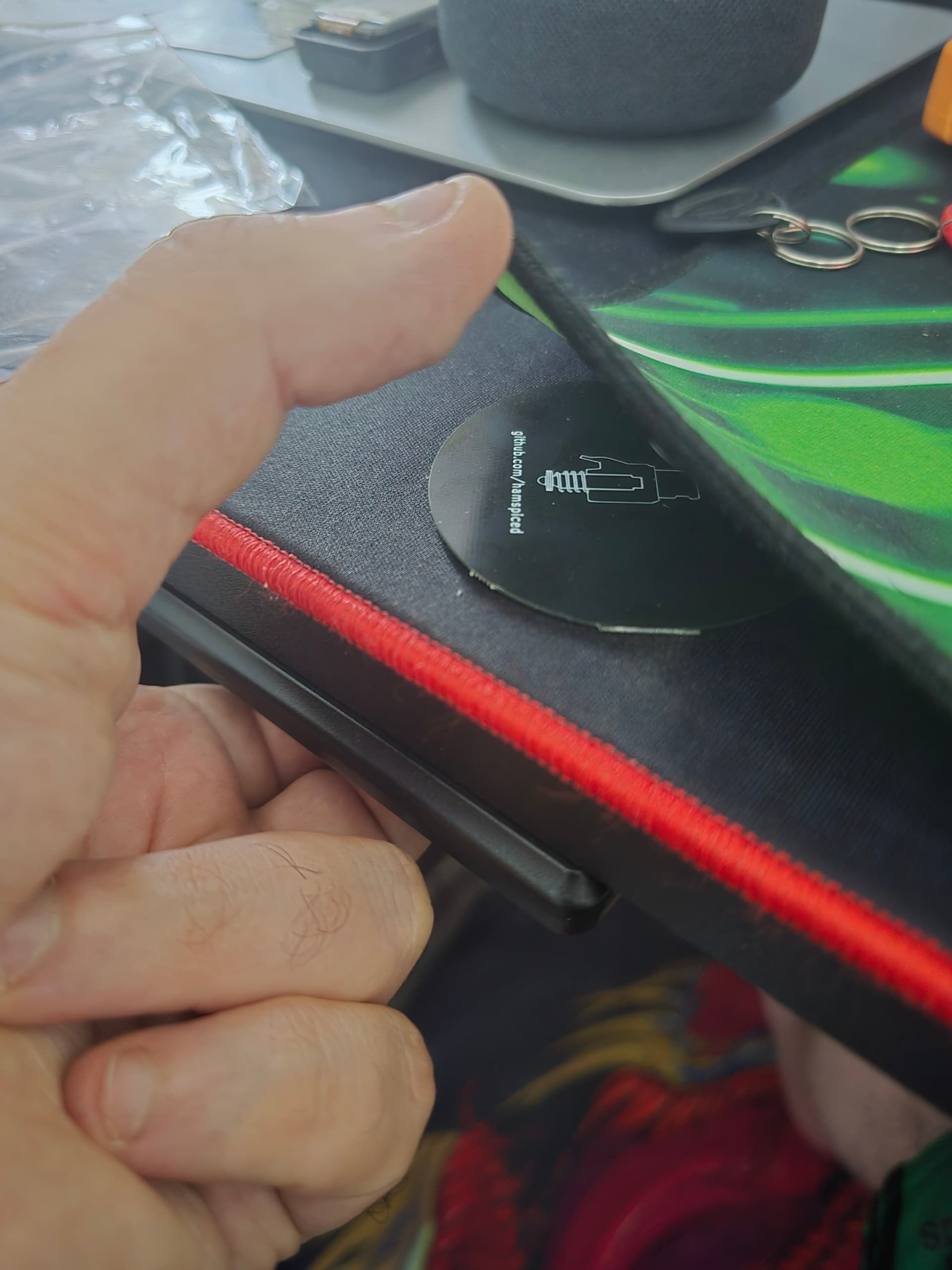

First of all I was eager I sticked one sticker to my phone and the results did not disappoint. I was able to read my x series from around 1-2 cm away and my apex from around 1cm to 1.5cm away.

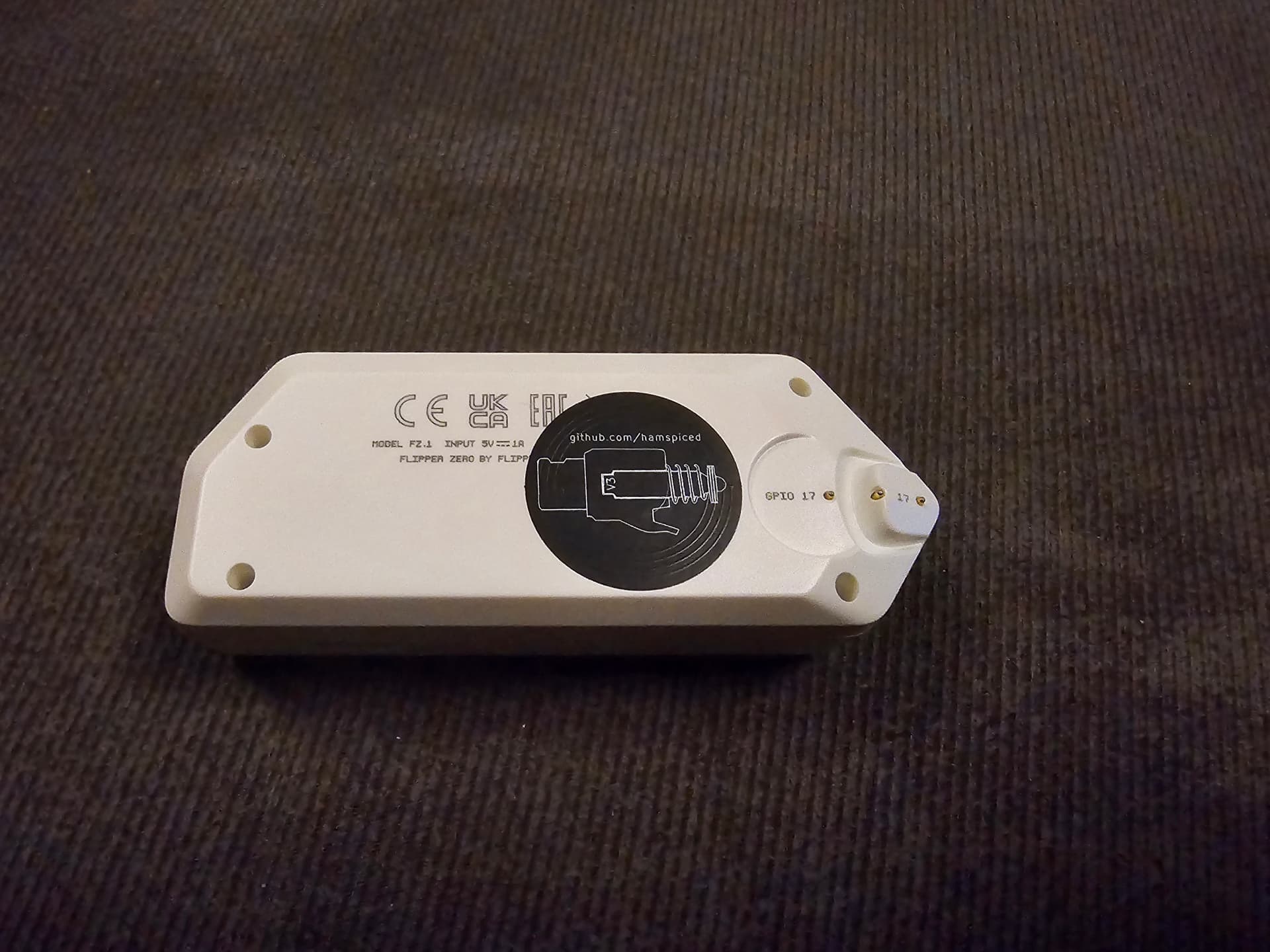

After some time I’ve decided to experiment more and stick one sticker to the back of my flipper. Here I found something a lil bit strange. As expected implants were easily readable, but I’ve noticed a very minor decay in coupling with cards. I mean you have to be picky where you put the flipper on the card.

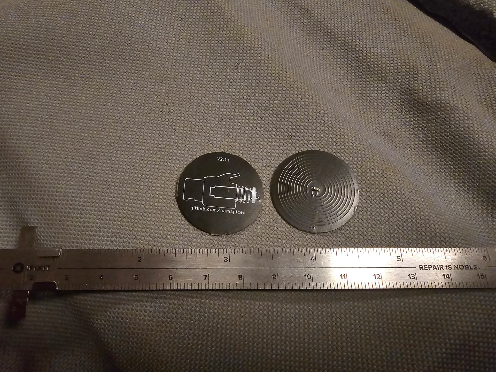

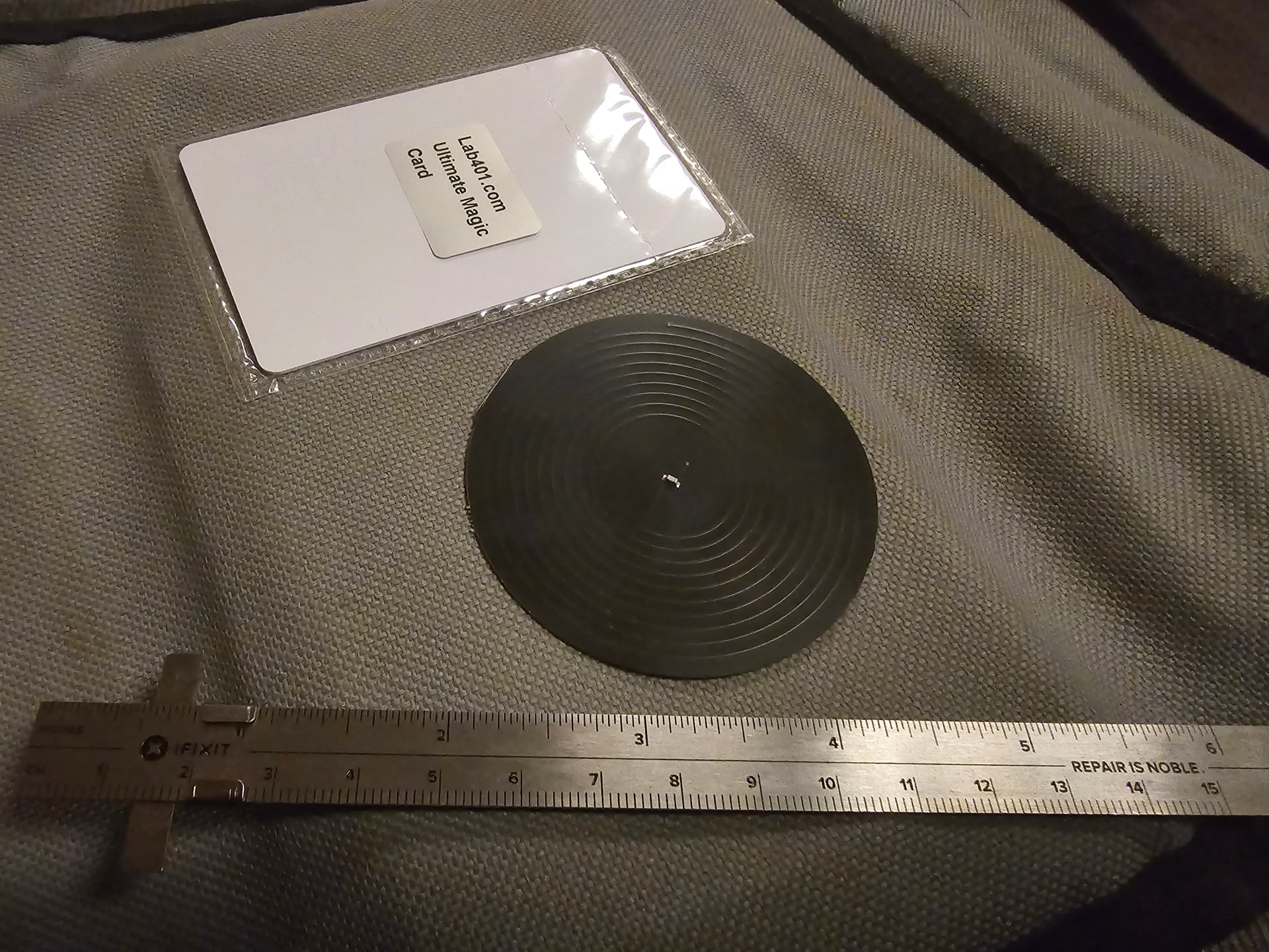

Last but not least the ultimate big boys v2.1L. Man, if we compared the 2.1 and 3.0 stickers to a 9mm, the 2.1L are 50 cal BMG. Range on those stuff is easily 5-6 cm from the reader. Initially I was placing the repeater on the reader but then I realised there should be some space between both so they operate correctly. Place your nfc reader under your desk and repeater on top. Sure, no problem, reading just fine.

phone - s24 ultra + UAG monarch pro kevlar case
no repeater - x series read 90% of the time on contact / apex unreadable
repeater - x series reads from 1-2cm / apex 1-1.5cm

repeater 2.1 and sticker 3.0 - x series reads from 1-2cm / apex 1-1.5cm
repeater 2.1L - reads everything either trough 5+ cm air, or via my desk made of some wooden material
F0 with silicone case
no repeater - x series, on contact / apex from time to time ~50% success
repeater sticker 3.0 - up to 0.5 cm max for x series, solid reads from the apex

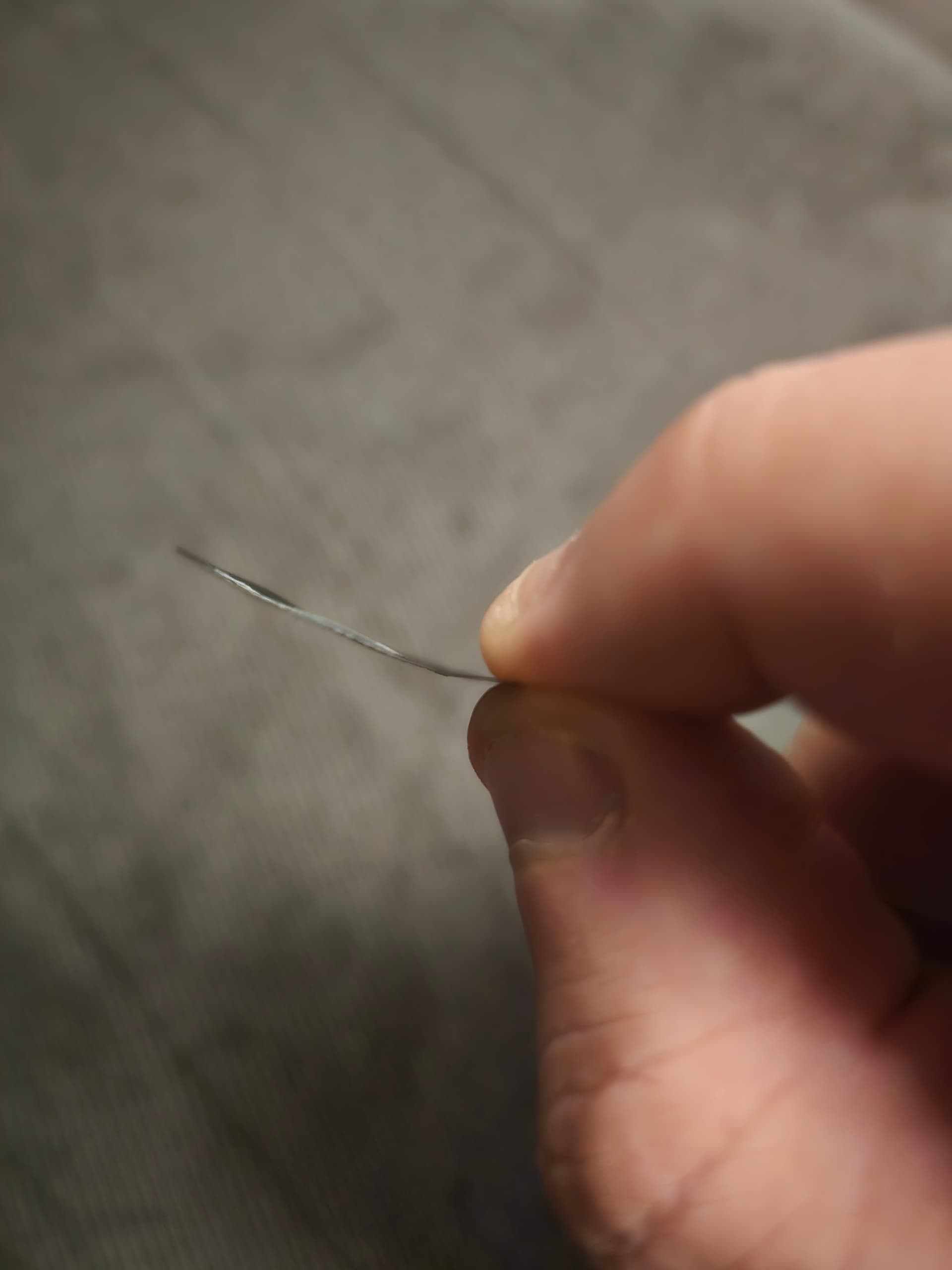

Successfully unglued the sticker from my flipper back, just to see how it will go. Adhesive is good. Strong enough to keep things in place, but not too sticky. It does not leave marks on surfaces. Unfortunately the sticker can deform a lil bit in the process, but it still works.

Placement for your flipper though is a tad different than i found works best. I have it on the back upper left.
