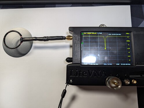

So How does it stack up against the V2.1L?
V2.1L
V3L
I have a lot of struggles with these repeaters and the capacitors that i get them assembled with. The capacitors have a tolerance of +/-10% usually and it throws off the tuning so i often have to test each unit. I dont “need” to be exact but within the range 13.56mhz but i make it a point to try to get tuning as dead on as possible. I cant do that with the capacitors when they have variances. With the capacitive plates i have much more control of the capacetence that is delivered and i get much more consistent results with the runs i have done.
These are now available. They will be replacing the V2.1’s as i am thrilled with their performance.
