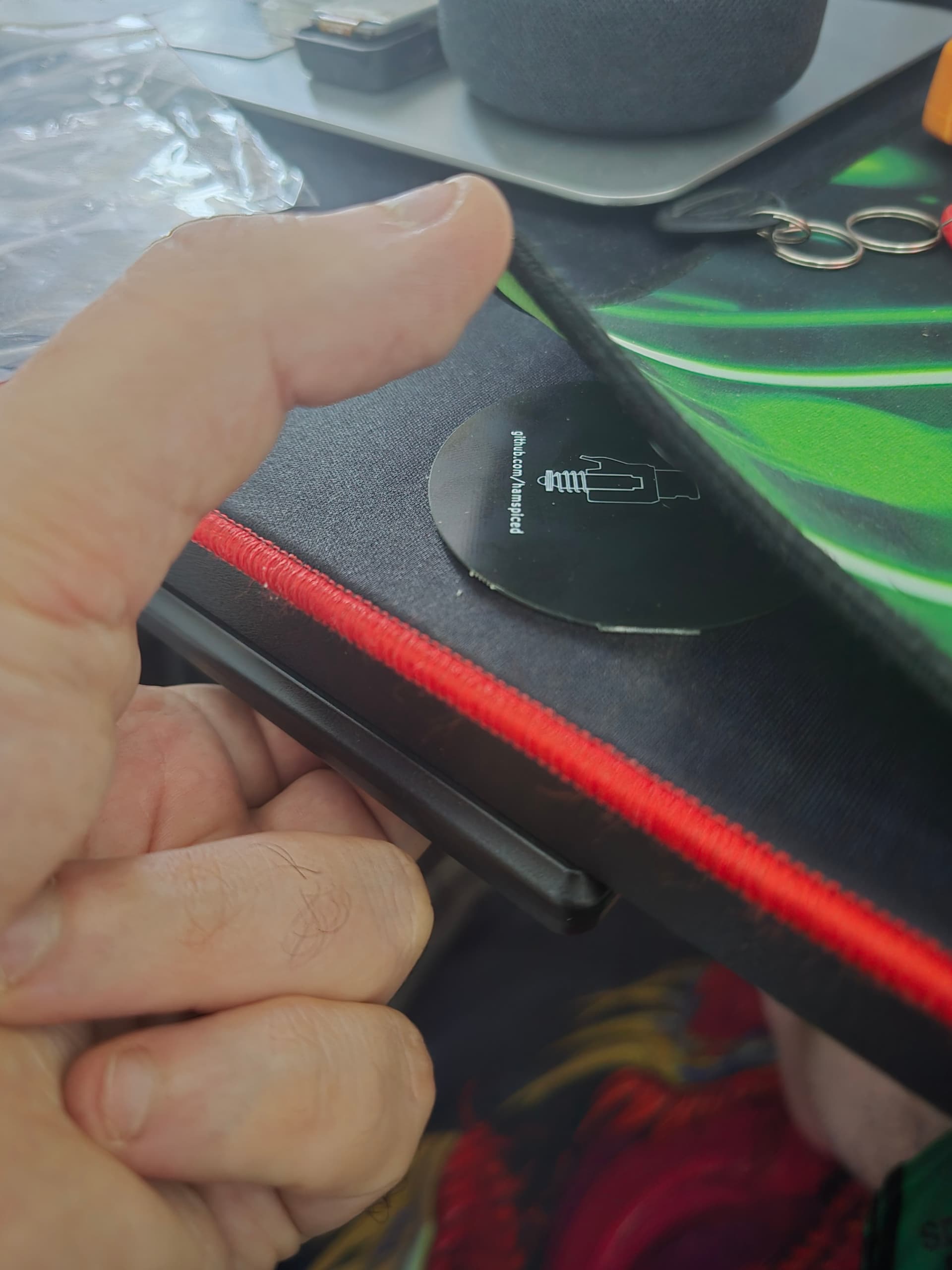

Right now I am playing with them. Finally I can craw to my desk with help of painkillers. What I can say so far, big repeaters have strange behaviour. Like the small one and the stickers can be sticked directly to the reader and they work, but if I place the big boy on it, it does not. Checking with the detector, it blinks like a hell, but no meaningful read. Placing the reader under my desk(one and somthing cm woodlike matherial) and the repeater on top(between two neoprene desk mats), gets the job done flawlessly.
I am still gathering data before dropping a big ass post about those cool gadgets.
The big repeaters need distance. They work really well but you need to put space between the reader and the repeater.
These show their true colors if you are trying to penetrate (thatswhatshesaid.jpg) a surface.
Place a reader under your desk with the repeater on top. Put your access reader on the otherside of your door and the repeater on the opposite side. I noticed this early on that it does work well but it needs more distance to really perform.
Yeah, they definitely do better with some gap between the reader and the tag.

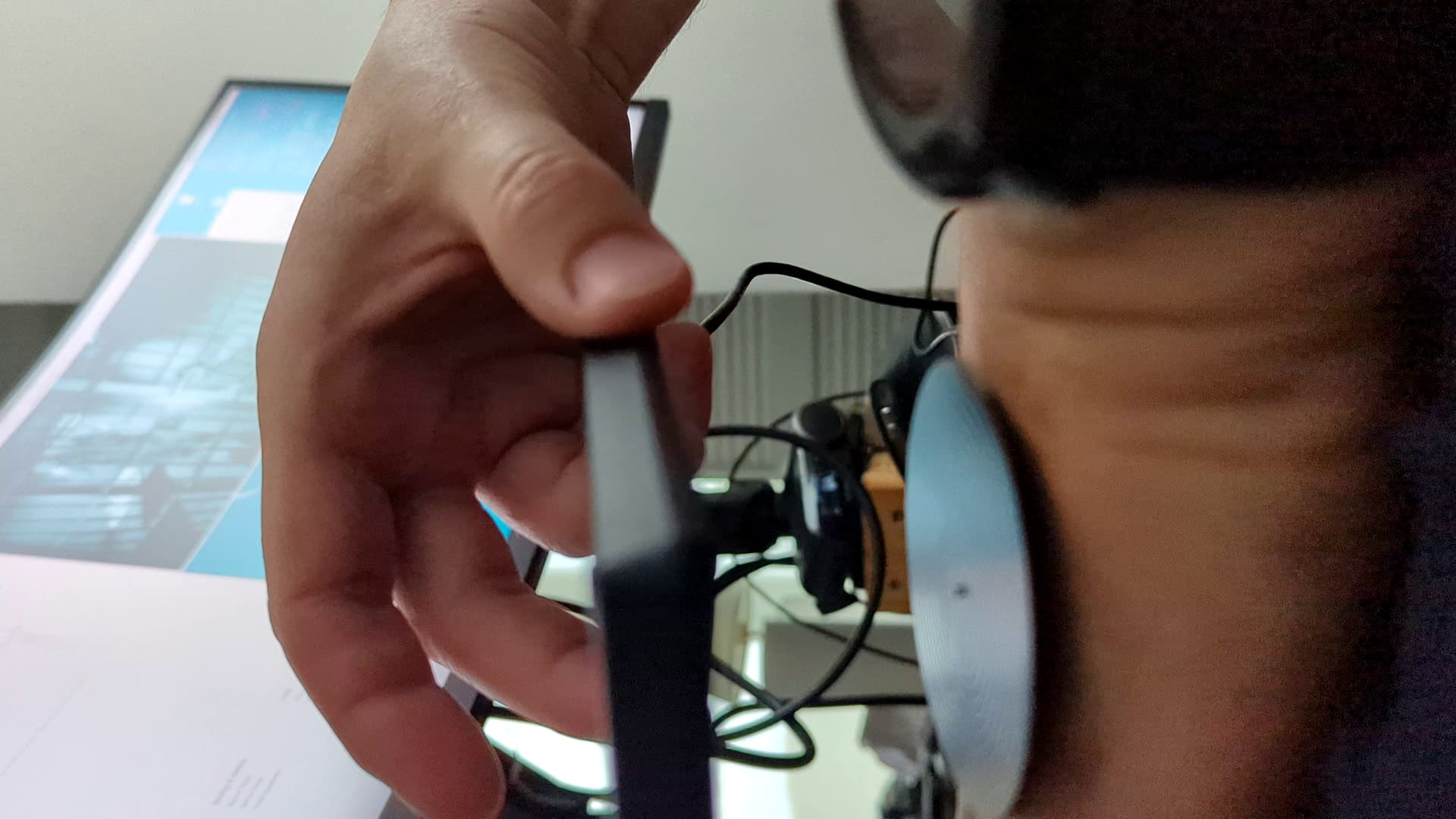

Reading ApexFlex from like… 1/4" away to over an inch+ away.
(sry about the sideways view, dunno why that happened. Too lazy to fix it right now, need coffee)
Edit: comparison of no amp and with amp. Trying to show reads further away with amp away from the scanner. coffee-less brain no thinky good
