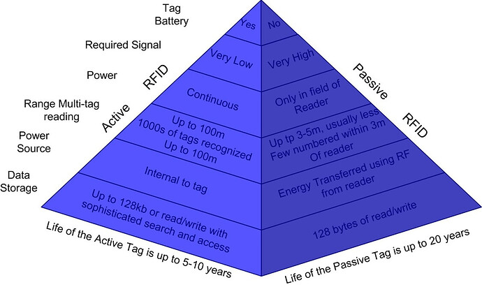

Ok thanks I’ll have to do a bit of reading, I found a decent infographic showing the differences.
Looks like active tags are still limited due to the receiver. For example a smartphone might ‘see’ the tag but the response probably won’t get back.
