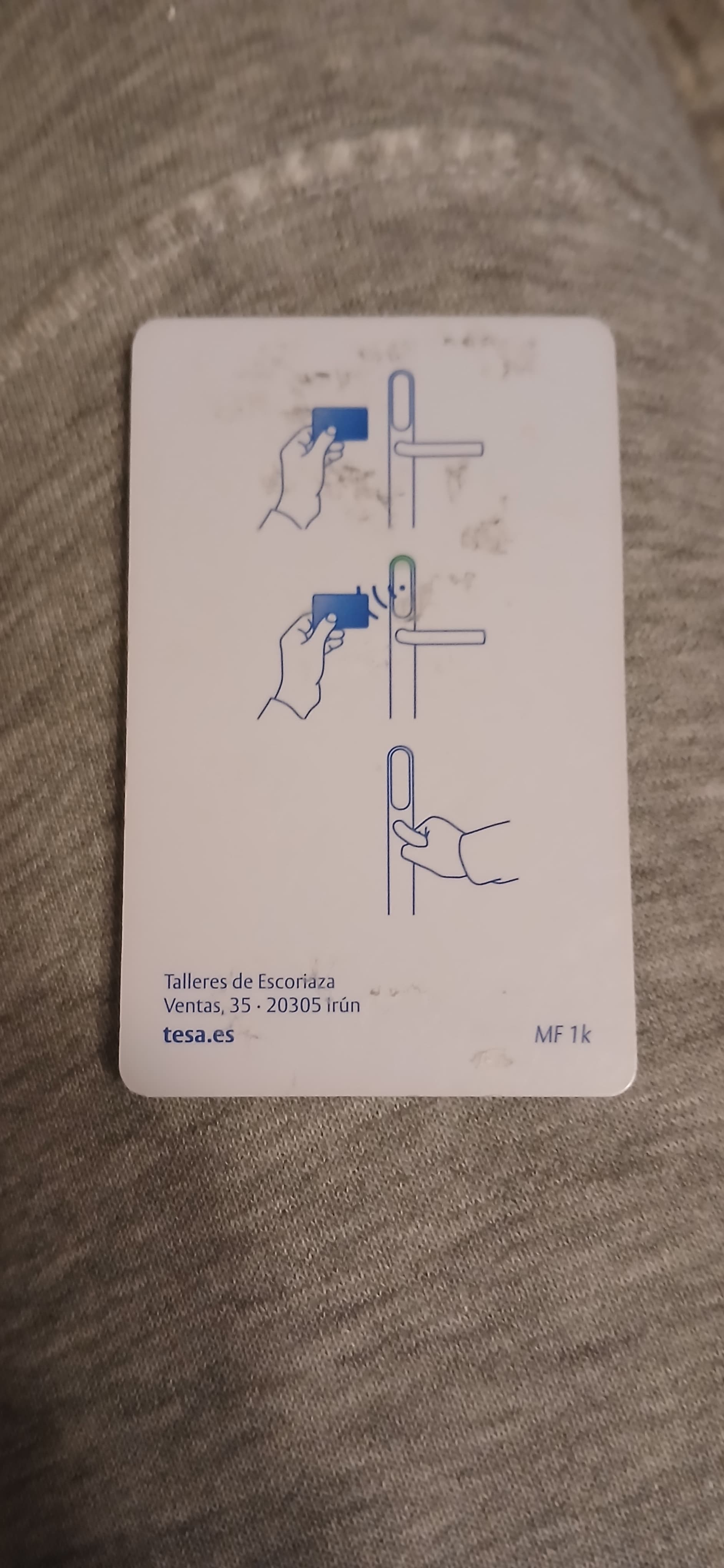

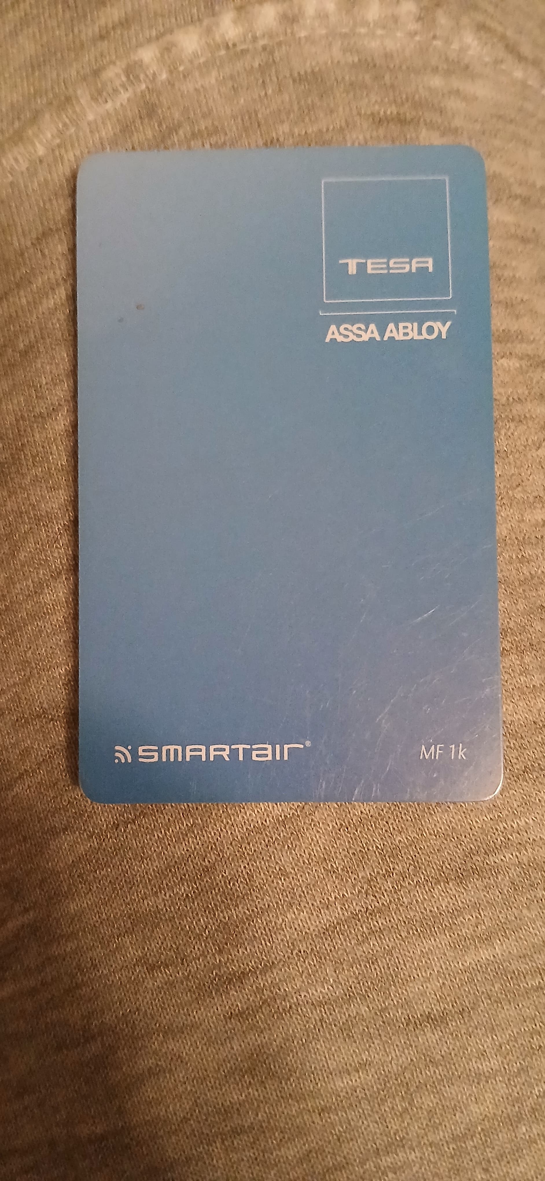

Hello guys, Im new here, and, id like to ask: how to format this nfc card?
This card is from hotel, i can read only to 37The card says “MF 1k” on it, so it’s probably a Mifare Classic 1k card. Have you tried using Mifare Classic Tool?
Also, what are you planning to do with it? Why do you want to format it?

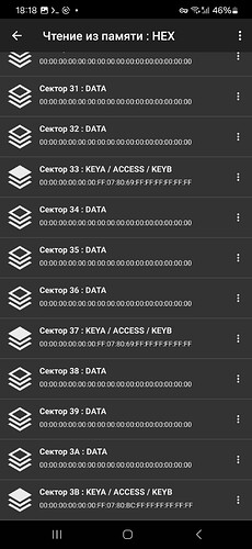

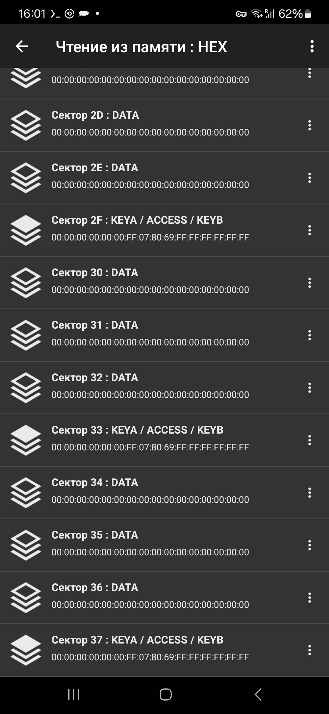

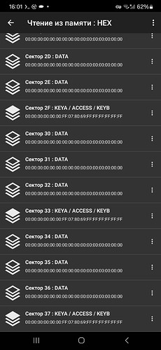

Reading is done. Results is here: https://pastebin.com/raw/umZMCXpT

Ah, I see. Looking at the dump I see there’s some data there already.

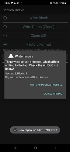

In MCT, go to “Write tag” → Factory Format, see if you can reset all the keys to default. This is to make it so NFC TagWriter can write to it.
Then try using NFC TagWriter, go to Erase tags → Erase & format as NDEF → Select no when asked if you want to specify user defined size.

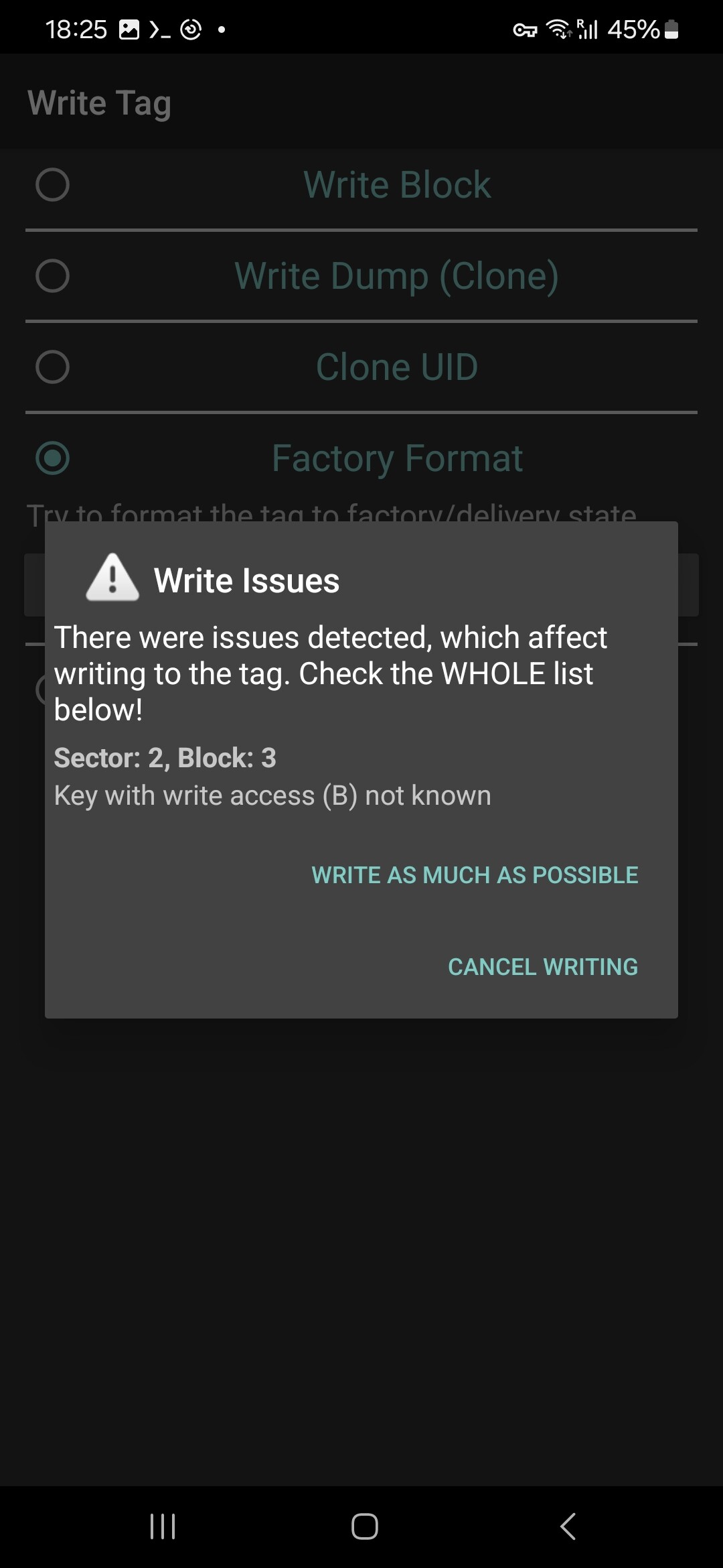

Done. In MCT says, that “Sector 2 block 3, Key with write access (B) not known”. Here is screenshot
Which key dictionaries did you try use when reading? Seems like you’re missing the key to write to block 3. Try using extended-std.keys if you haven’t already. Otherwise you’ll need a non-Android NFC reader to crack the keys. For example a Flipper Zero or a PC with a USB SCL3711 reader, or a Proxmark.
I’ve used extended-std.keys to read, and then saved keys that worked in a file, and i got
000000000000
E7316853E731…
Try to format it with extended?
Try that! If it doesn’t work you’ll sadly need to use some other tool to find the key.
I’ve tried to write after both formatting, and it worked! I cant format it from nfc tools, because it cant read last 4 blocks, from 3C to 3F
Well, sadly this means you’re still missing a key. In theory I think it should be possible to set up the formatting in a way where it skips the sector, but I don’t think there are any Android apps that allow you to do that easily. Your best bet is probably to either buy a cheap libNFC supported reader, or find a tag that doesn’t have keys set from before.
