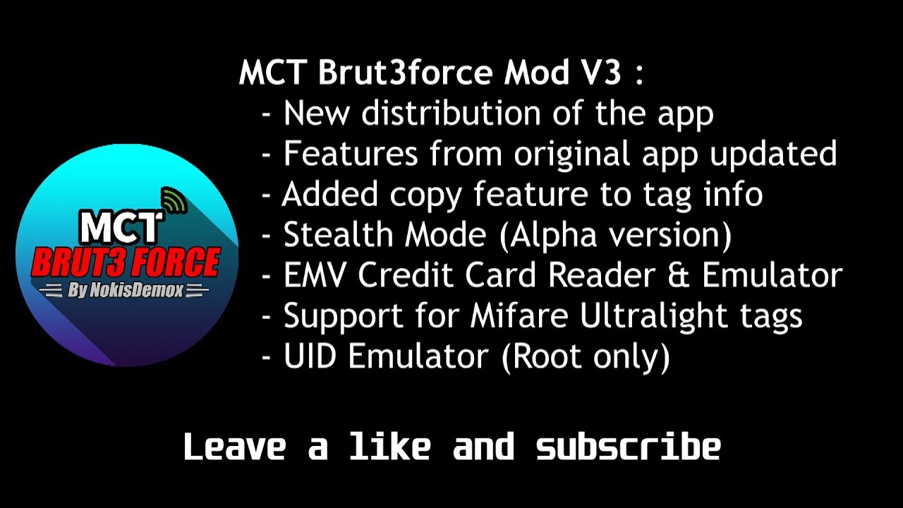

Howdy :} some ppl (devilclarke and leumas95) helped me sort a proxmark3 easy and sort the UID changing things :smiley: the link for the MCT apk is MCT Bruteforce
:smiley: thanks
@Equipter
Just thought I would share your accompanying YouTube video
