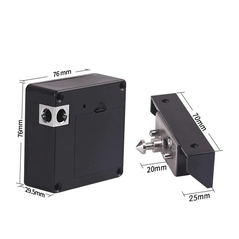

On the Matrix, there are a couple of options for padlocks, plus with some modification, you may be able to get a furniture lock to work for you.
I need to add the one below, onto the spreadsheet, I have a couple of these, But I haven’t tested it with any implants and I am currently away from my locks and pelican cases where I could do some testing for you, but I won’t be back with them for just over a week…
I do know the Fob is Mifare 1K, But I could see this working as a good option for your “problem”.
The bonus of this is you can also get a backup power supply to reduce the chance of being locked out.

@kvasarnomad
So I did a quick test with my NExT and a NTAG216 test card on this lock, it wouldn’t even recognise it, but with Mifare 1k gen1a and gen2 magic test cards and it worked fine, but I STILL haven’t got myself a FlexM1 implant so I can’t test that side of it for you.
I hope that is still of some help
