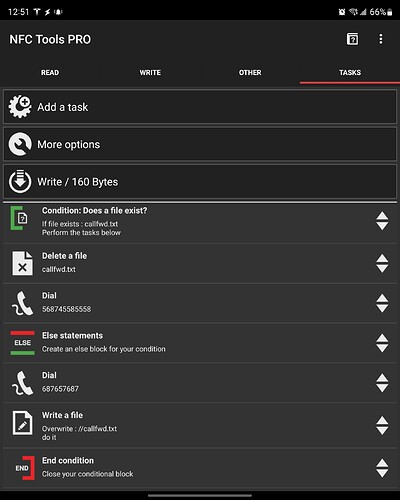

Pretty sure those are two separate actions, is there a way to set it as a toggle?
You could use tasker https://youtu.be/t3cbS3aez6M it’s not as easy to use but I think you can make it do what you want.
Looked more at it and you can do it in nfc tools if you go to tasks and include conditional blocks

Thats exactly whattsapp i have ![]()
