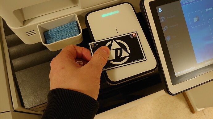

We have this printer at work, where we have to scan our card to copy/print etc.
It reads my work badge great, and the diagnostic card lights up like a christmas tree. - but no matter what direction I try, the xFD doesn’t light up at all. (nor do I manage to get a read on my xM1)
The only thing I noticed is that if I look at the led on the diagnostic card through my phone, I notice that it flashes really fast (looks solid red through the naked eye)
Any Ideas?

Is it possible to pop open the reader to see where the antenna lays.
OR
With your Diagnostic Card, the HF antenna runs the perimeter, can you use just a little bit of the short edge to work out where the readers antenna is, so you can then focus your attention with the xFD. (it is not as precise as the xFD, but it will give you a pretty good idea.)

So I cloned my workcard to the FlexM1 and tried again, and no result whatsoever
I found the brocheure for the reader on the printer, and see that it supports a whole bunch of card technologies… so my suspicion is that my workID contains both a standard mifare chip and something else as well, that the printer reads. - that the diagnostic card lights up because the reader supports mifare, but might be configured for something else
The interresting thing is: if I place the diagnostic card on top of the reader or underneath my card, it refuses to scan my card.

So I brought 3 magic cards to work today.
1: clone of my workID
2: clone of my workID but with a different UID
3: clean card with just the UID set equal to my work card
So the result is: the reader responds to all of them with a good range. Card 1 & 3 logs me in. Card 2 reads, but asks me to enter credentials.
Summarize: the reader only reads the UID, and any UID. it accept magic gen1a cards, and has a good read range (3cm)
… But no matter what I try, it does NOT read the xM1 nor the flexM1 :expressionless:
Last test will be to bring the unimplanted flexM1 and try to see if I can find a sweet-spot with that🤔
