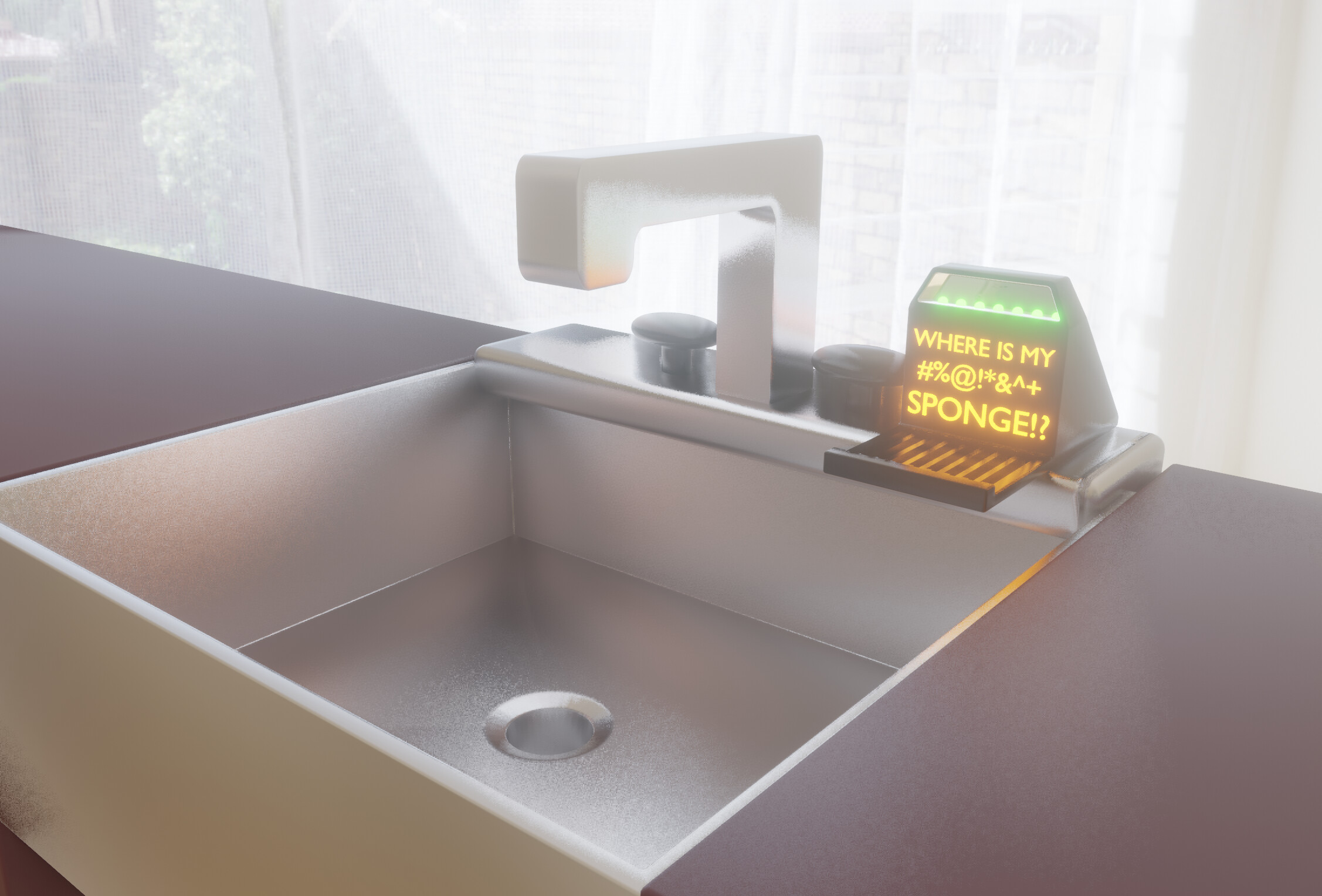

Depending on your sponge, you could add a plastic tag that don’t mind to be wet.
An Arduino, Reader, Buzzer.
Sponge gets removed from in front of the reader and a countdown timer starts.
After some seconds the reader will check that the sponge has been returned to its place, if not BEEP BEEP BEEP BEEP.
You could aim to “train” your dad by making him get the sponge close to the reader every few seconds even before he finish using it, so he will get used to the motion of putting it back in its place.
But to be honest, the most probable thing that will happen is that he will disconnect the noisy shit or plain old smash it with a hammer until it shuts up.
UI vs UX
If he is not consciously against putting the sponge back in its place, you don’t need to be so “offensive” with a loud noise, a blinking LED indicator should be enough. Maybe a message?
Nice artwork Ryu, you clever little dude! :+1:t3:

Really like the way you made the unit there. He will definitely just put the sponge back as that is way easier and less effort than destroying it. Also, he will think it’s somewhat funny.
What kind of tag is that in the first picture?
Pretty sure that is a UHF tag
