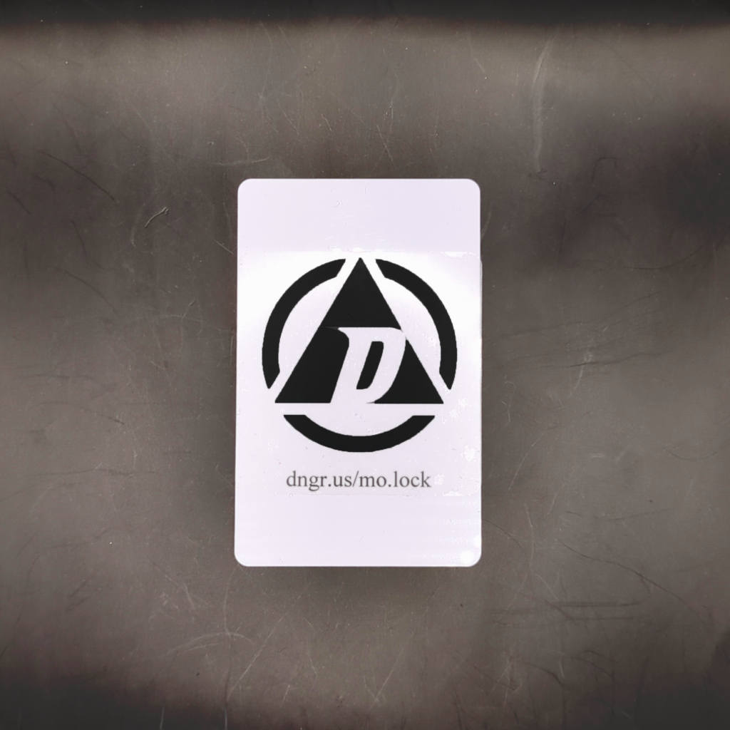

Now offering aftermarket mo.lock keycards!
Those folks at motogadget charge about $40 for their mo.lock (the NFC version) keys–we can do a lot better. And we have : )
