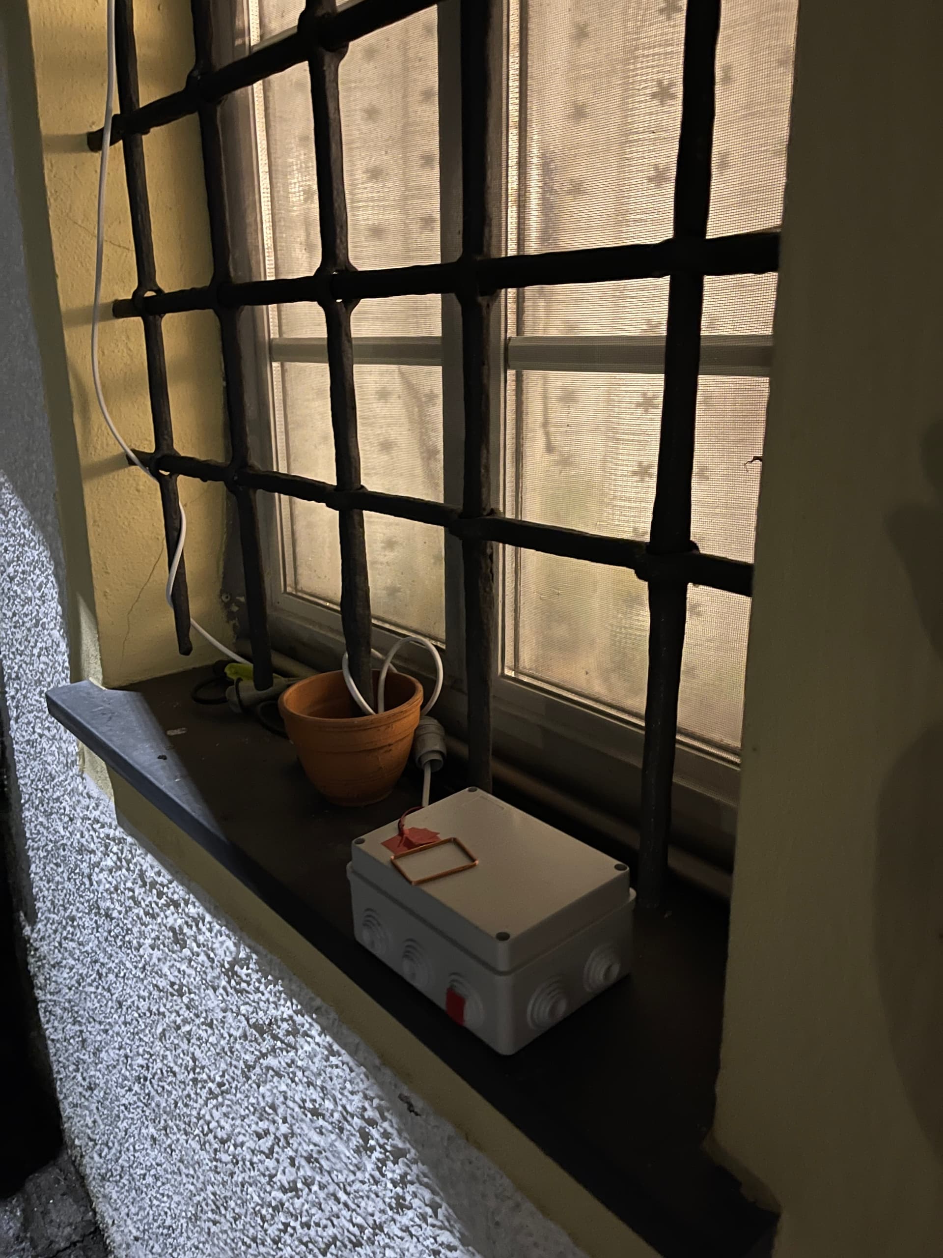

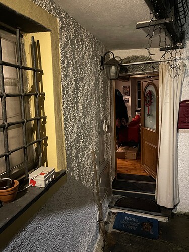

This is my door unlocking tool, based on Esphome & Home Assistant with a WeMos board and a Nuki 2.0 smart lock.
I use the 125khz chip with a good performance RDM6300, very easy to configure with EspHome and… It works well!
Hope you enjoyed it. Happy new year to everyone!
Giuliano

Anyway, for now, part list is:
Wemos D1 board (mini is good to and probably any ESP8266/ESP32 board)
RDM6300 rfid reader with external antenna
DC Power supply (i use a 12v from cameras and wemos has plug that support it)
Home assistant is running on a Raspberry PI 4 and has the NUKI integration to control via aitonation the NUKI 2.0 with WiFi bridge in the same network.
