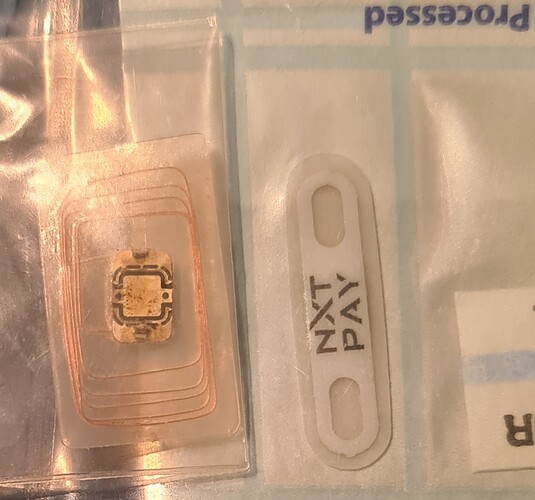

The first version of the nxtpay was broken
Here is a picture from the old and the new chip

You can’t read the broken chip.
I send it to Amal.
I mean with the new one which is not broken?
