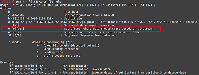

Please help to explain and how to set the offset value of the T5577 (the below list was read back from the card, there is other card with offset:31, how do I change this 32 to 31).

It’s not a T5577 setting, it’s a Proxmark3 setting:
