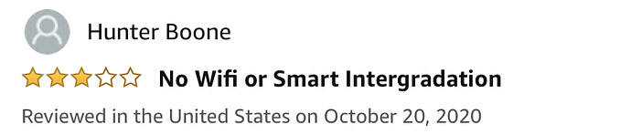

There’s a review you might enjoy
Nice. I’ll keep that one in mind if I need to outfit a door that I can’t find a proper lock case or handle replacement for. The website doesn’t say anything on its ability to actual latches. I suspect it can only turn deadbolts. But maybe not.

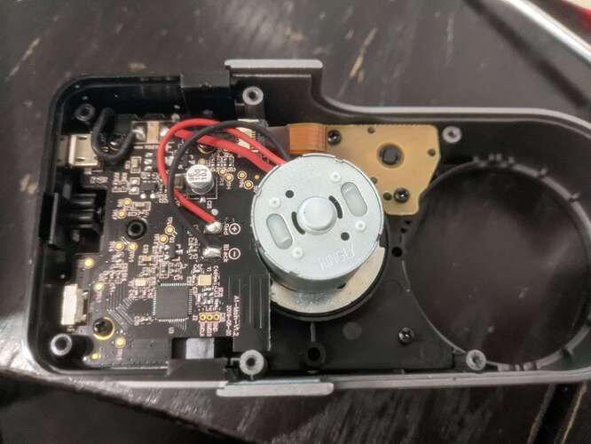

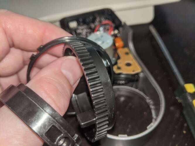

Ok I’m sending off one of my unopened gimdow locks to @Devilclarke to see if he can explore some of the ideas in it and make some CAD drawings. Looking at these locks again got me curious again so I wanted to take it apart to understand how the tumbturn and key side could operate without any resistance at all… I didn’t get too far in my investigation of this but I will post stuff anyway until I or Dev can get more relevant info posted.

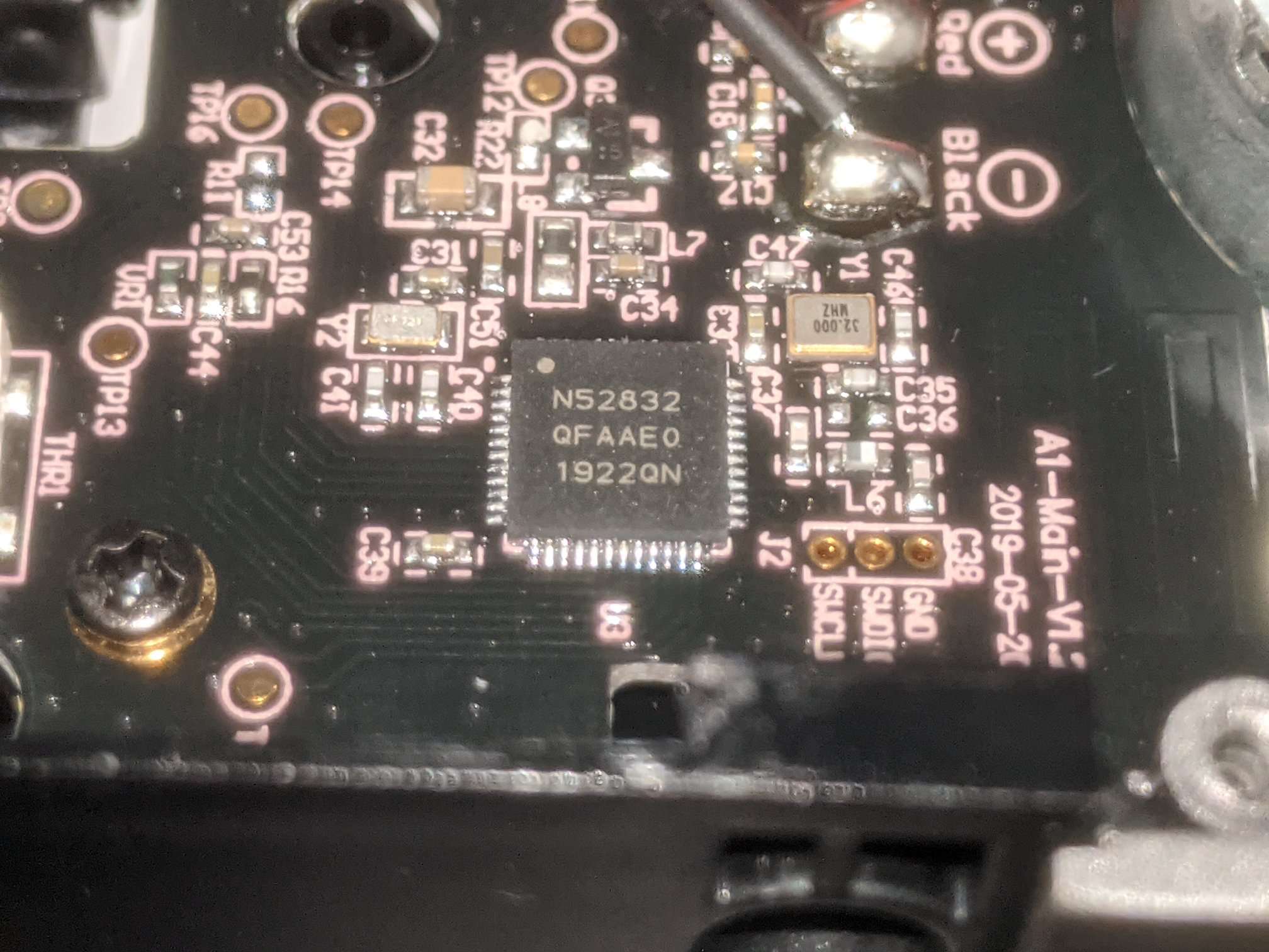

Inside is a very simple looking control PCB… basically motor control, wireless connectivity to the pin pad, and hopefully the security access list is contained here and not in the pin pad… but not sure about that yet.

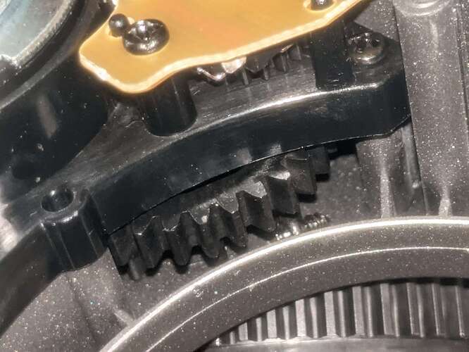

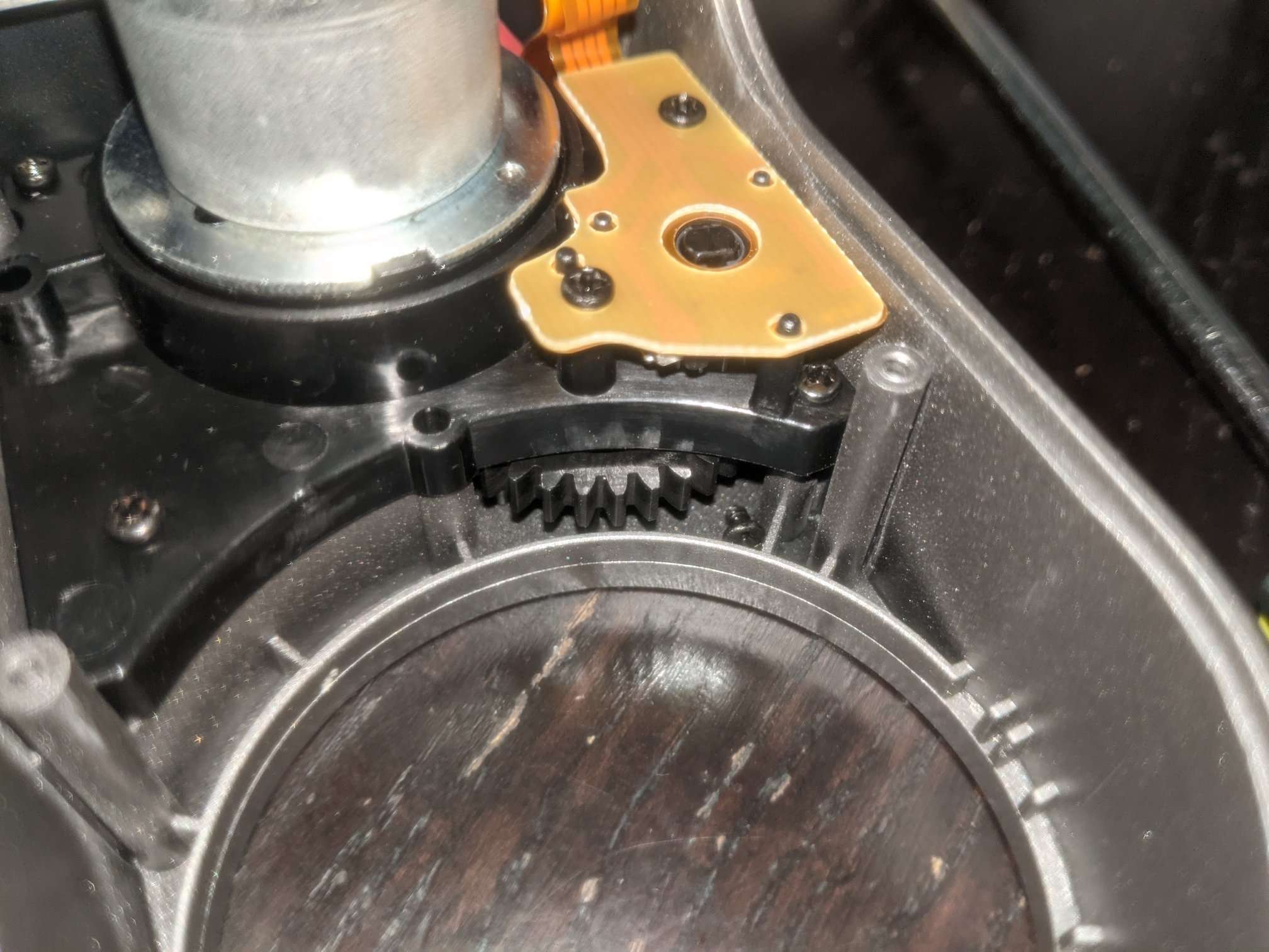

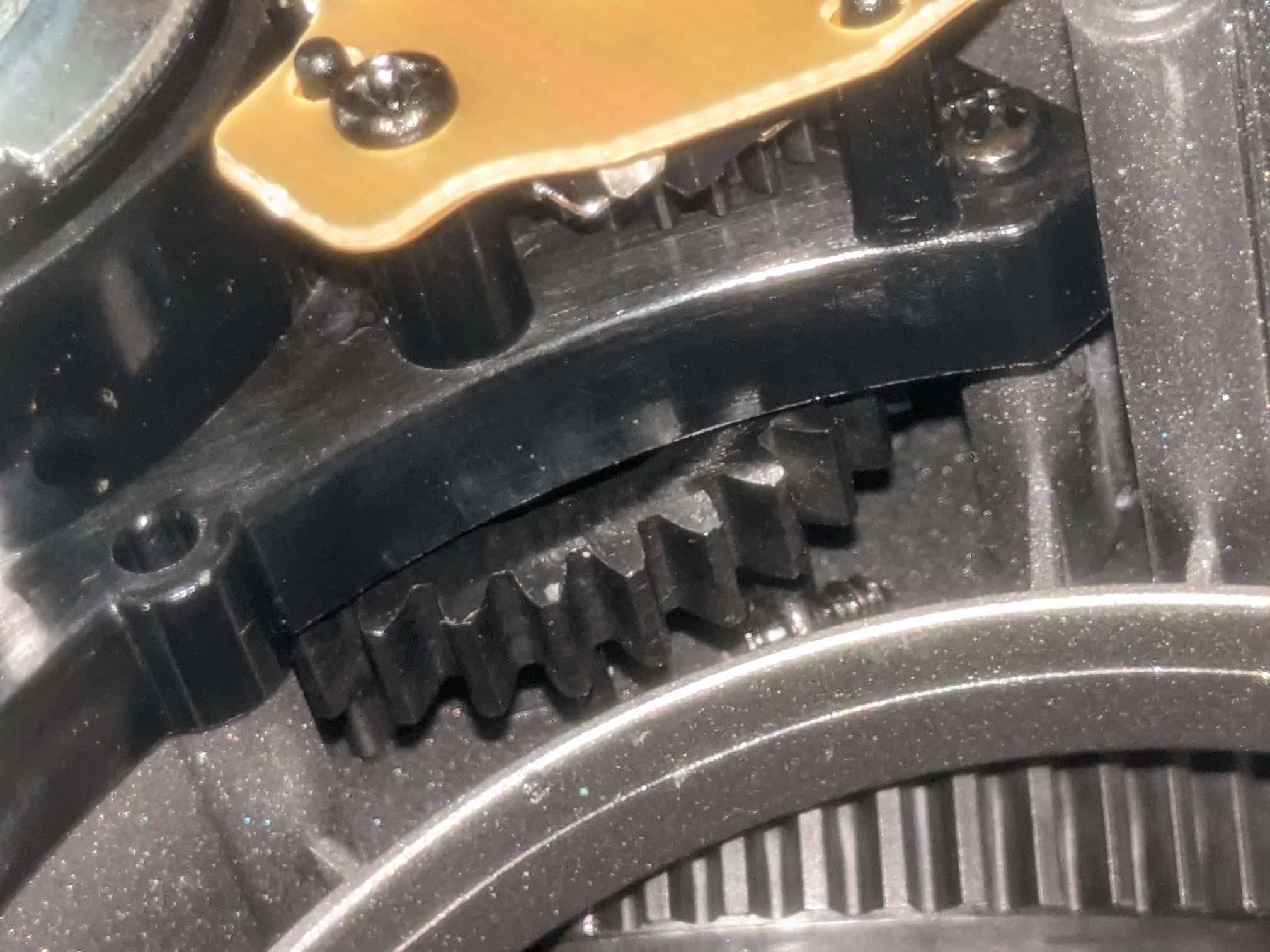

The turn system is a gear driven ring… not sure yet how it manages to spin freely when the motor isn’t engaged… or rather, I’m not sure how the motor driver gear engages the ring when spinning… it might be a centrifugal system that pushes the gear into place… but my attempts to grab the drive gear with tweezers to see if it would swing out resulted in no movement… so not sure yet… but here are some more pics of that gear system…
notice the loose screw in these photos… this was from the factory… eehh…
… more to come later I’m sure…
Maybe I’m missing something, but you can freely spin most motors when they aren’t engergized
Yeah that’s on me… the stupid screw was rattling around in there and must have jammed that drive gear… because with the screw removed it spins freely.
