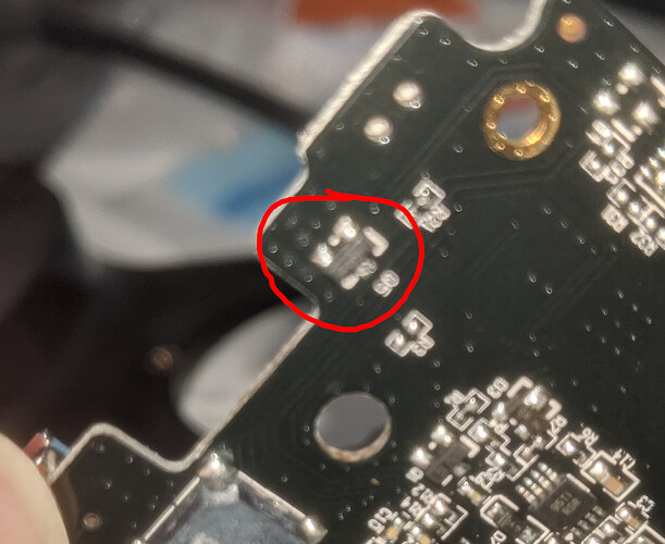

I only half-way did… I didn’t set up the app or anything but I did put batteries into it to see if it did anything… I also tested the switch, which seemed to do nothing… but I didn’t actually link the pin pad (took it apart immediately) so … egg’s on my face because…
By sheer coincidence, I happen to have some magnets lying around… it snapped right to it. Upon closer inspection of the PCB, this little fuzzy looking component right here…
… turns out to be a hall effect sensor. me wrong.
the question I have now is … why? why go through the trouble since it’s not weatherproof by any means… why not just put a mechanical switch there? it can’t be due to wear concerns on a mechanical switch because honestly… who’s going to turn this thing off and on again on a regular basis? it boggles the mind.

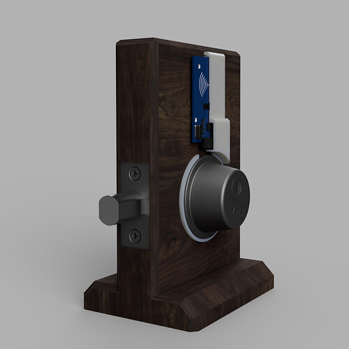

Sooo… I made something. It’s not secure, has a less than 2 day battery life, and is quite a bit fugly on the inside… But I can use my NExT to enter my house.

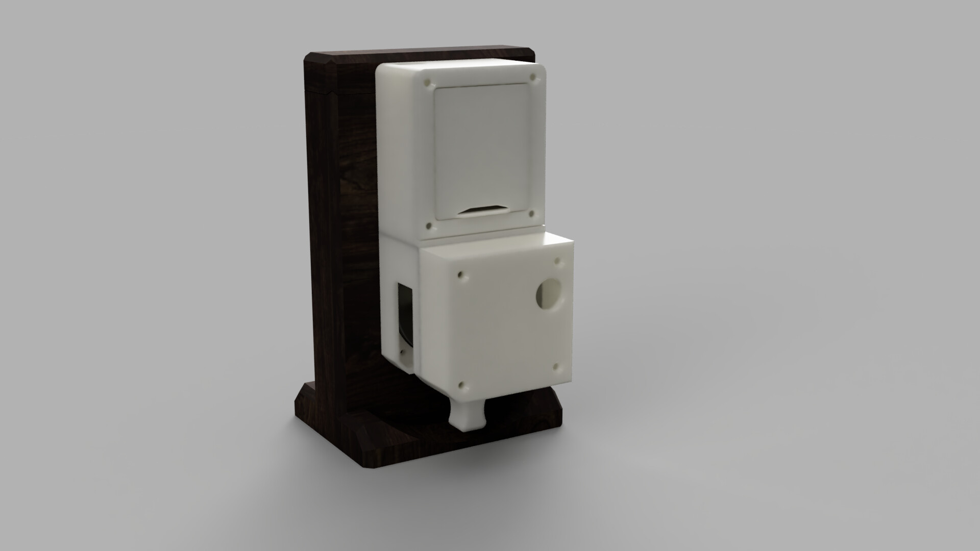

I was able to rope in some classmates to help design this thing for our pre-capstone project in 3 months. It’s all open-source and freely available to put together. Please excuse the terribleness in the design, documentation, GitHub management, etc. Many pictures, documents, and designs here to look through including STLs and a Fusion 360 archive file (I have a seriously terrible timeline I’m sorry.)
The goal of this project was to be able to use RFID/NFC on the existing lock on a rental with a minimal outside footprint. No extra holes needed for the reader. This comes with some security problems, however, for me the convenience is great! The way our door is placed, however, it’s quite uncomfortable to contort my hand to scan correctly, so I’ve ended up using other NFC tags more regularly.
It uses an ESP8266 module on a custom breakout board PCB based on Adafruit’s Feather platform. Designing a PCB was a requirement for the class, but this can entirely be made with a Feather and is my recommendation since it has LiPo charging circuitry. To use this on a daily basis, I’ve had to wire in a micro usb cord to power the ESP. This is due to using a prebuilt RFID project, ESP RFID that we have modified to work with a servo. Our board bypasses the USB power to pull directly from the AA batteries so not to tax the LDO, however, this means batteries are still required even when using power. Using an Adafruit Feather with a lipo would definitely solve this limitation.
Our specific implementation uses a cheap RC522 module, but can easily be used with other modules thanks to the good folks who made ESP RFID.
I’m currently testing out our implementation on my door and so far so good. I’m most likely going to replace the 3x AAA batteries with a small lipo charging circuit due to needing to change the batteries frequently.
All in all, this was a super fun project to work on even though the implementation is quite a bit limited.
