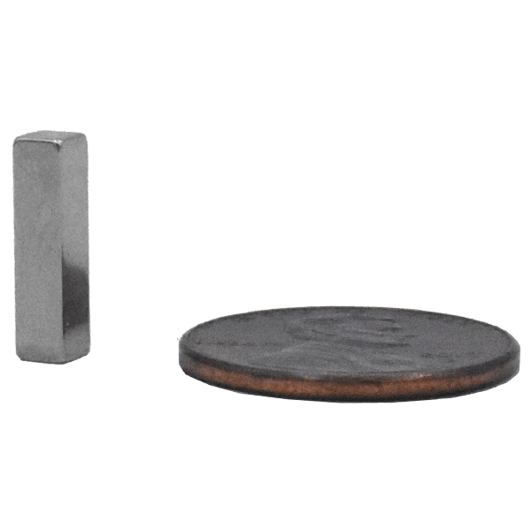

So the new M04280bar has just been released. So I decided to get out the calipers and size check it. I love the idea of being able to install a magnet using the g4 applicator when that comes out. But As you can see. 28mm is half the size my masculine yet petite hand.
After speaking to donfire. I have learnt one can not simply chop a magnet in half and then resin coat it…
So I’m curious if dt will be doing a m0414… we have spent this morning looking at magnets
My only caveat is will a cube sit comfortably in the hand compared to a rod. And how will this affect preformance
We can do other magnets of course.. and honestly.. yes we can chop one of our bar magnets in half and coat that for you as a custom project. I would rather do that to one of our N52 bar magnets vs encapsulating an N50 magnet. Weak.

Could I be so bold and request a magnet to be chopped in half and tested like the other models. To gauge it preformance.
Just ordered 3mmx3mm n52 rod magnets. Hopefully 4 of these will make a 12mm x 3mm magnets. That should fit nicely under a bandaid Should be here in 3 days…
Accidentally broke a bar magnet.. can shave it down though.
We also have these ~5mm cubes..
Just order the regular bar magnet and put the notes you want Lil Stubby here instead.
1.22g, 1900G, ~1557rp.
