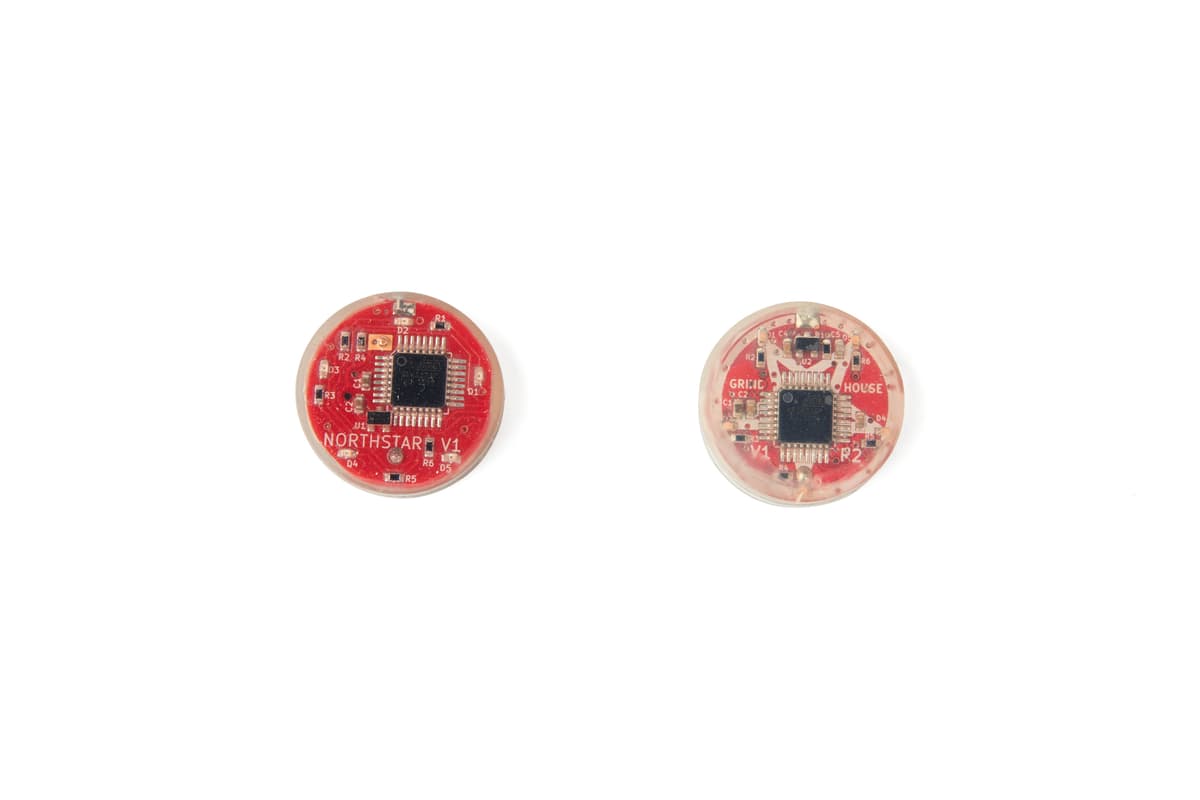

Apart from that, I was reading an article yesterday about Northstar V1, I saw that it is also powered by a 3V battery?
northstars are pierced to the skin, not implanted. If it explodes you can rip it off.

I’ve seen the Northstar V1 under the skin with LEDs on it.
northstar
does not equal northsense
