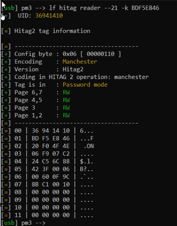

can you run
lf hitag
and share a screenshot
maybe
lf hitag help
thanks for your reply. here is the output
Cool,
there are a few things to try in there
I would try
lf hitag reader
then when you have the read data
try
lf hitag writer
it will [potentially error out, but prompt for the next step
And potentially give you an example you can then copy and adjust your your required data
and repeat the process
Do you see how the commands work
It just gives you options, you choose one, then follow it step by step until you get what you want

Hi someone previously provided me with the output of the paxton card, im not sure where they got
-k BDF5E846
but it seems to show all the data on the paxton card, so now when i write this to the wristband, would it be --27 or -p
do all the pages and password need to be written.
wolud this be page 0
lf hitag writer -p0 369414106
you don’t need to write p0, you also can’t.
that BDF5E846 is the paxton net2 hitag2 global password
thanks, looking at the example to write page 1 and 2 wolud it be
lf hitag writer --27 -k BDF5E846 -p1 -d BDF5E846
lf hitag writer --27 -k BDF5E846 -p2 -d 20F04F4E
do i need to write the other data on the far right, like 6 or ON, f, $ etc
that is the ascii interpretation of the hex data you’re writing so no
i keep getting a detected header error
i am doing
lf hitag writer --27 -k 36941410 =p1 -d BDF5E846
is this the correct way to write page 1?
-p 1
add the space
e2a: you messed up the syntax too
lf hitag writer --27 -p 1 -k BDF5E846 -d 36941410
