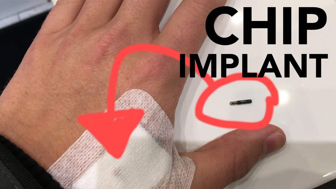

You saw that video online with the guy at the shop is it buzzfeed didn’t you!
Or do you mean this guy wearing merch??
if it was the latter then looking through the comments you can see that he’s got one of these!
