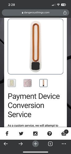

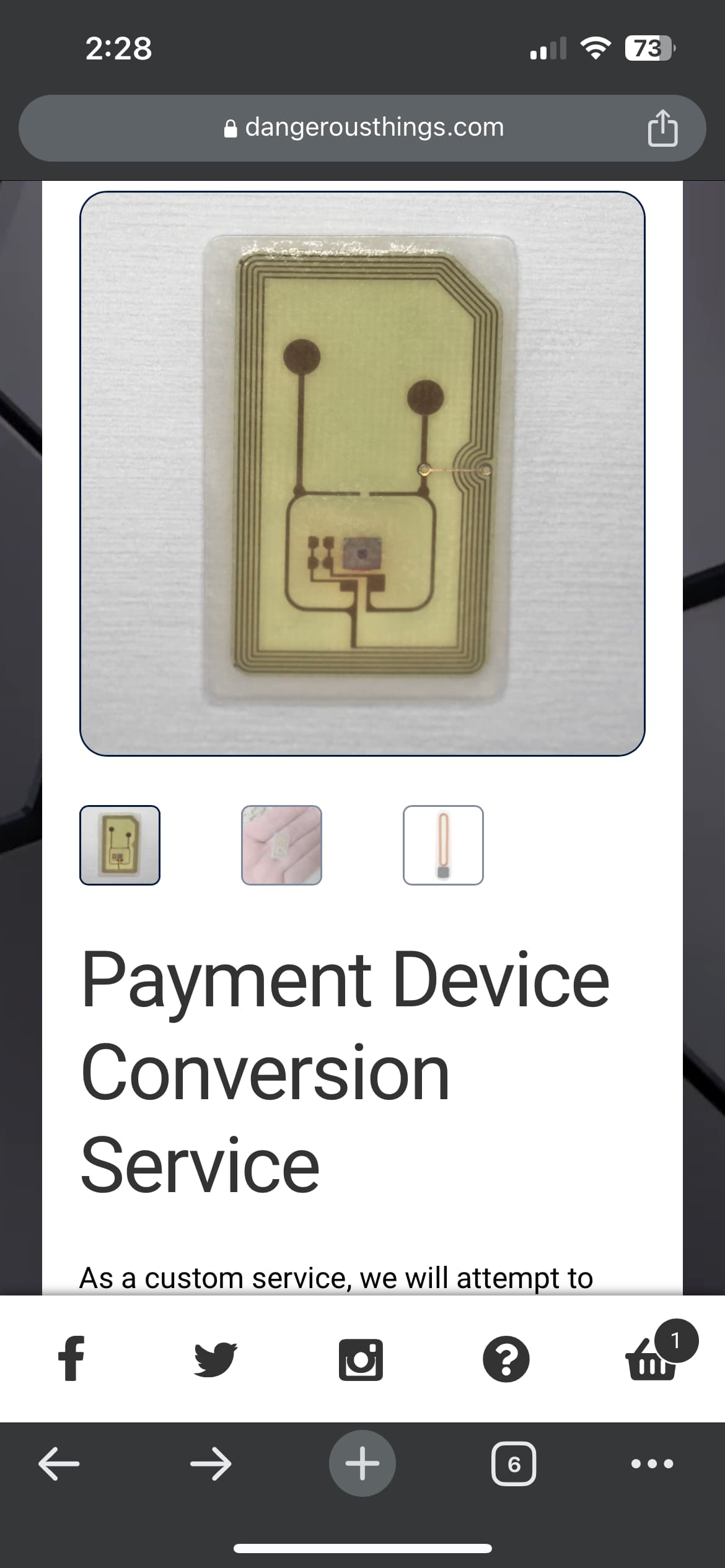

When I place an order for the conversion, I notice that there are two types.
Can I request this version:
Instead of this version?
The type of conversion is based on the source device not the end target… the bottom example is the only option for those types of source devices because the chip is flip-chip adhered to the antenna substrate and cannot be removed. The top image shows a chip that was removed from the source device, it’s original antenna disconnected, and the chip connected to a new custom antenna before encapsulation.

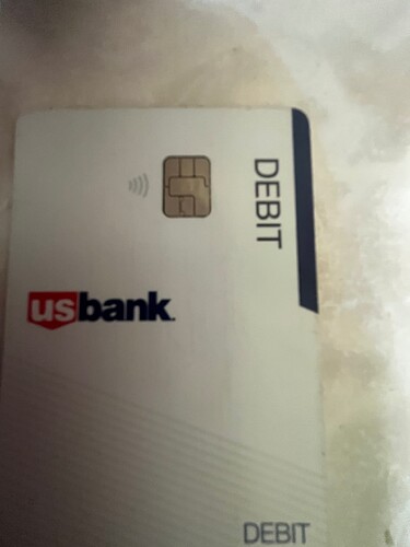

I have 2 bank card that was confirmed by Satur9 to be able to work for the conversion. I want to place the implant into a magic wand for use as a payment wand. The long skinny implant would be the best because it will go up the wand, whereas the other one is too much real estate for my need.
IMG_1292
These are the chips on my two cards.
The bank cards in question are Coil on Module. You can’t attach an antenna to them, they need to be paired with a separate board. The end result will also end up being as big as the contact interface, which is anywhere from 9.5-12mm wide and rigid.
Most credit cards can’t be converted with the conversion service, because the bare silicon is attached to the back of the contact interface and covered in hard resin. The antenna connections are not readily available to be connected to and every card would need a different antenna.
