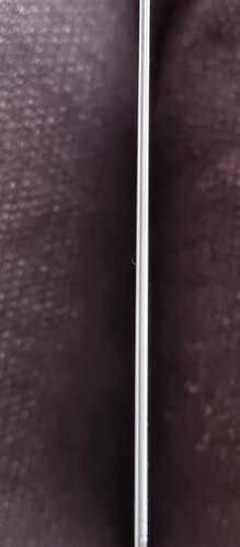

I haven’t pulled it apart yet, but I think it is a two layer laminate, with the bottom being the thickest (providing the heft) is metal, and I think the top thin layer is possibly a plastic or composite
if it’s uninterrupted metal then it blocks the contactless. They might be advertising that the metal card has “contactless” because of the tokenization option available in the companion app, while the card itself does not.

Correction to my laminate layer
Metal top layer, plastic/composite bottom
It’s probably 75% thickness is metal 25% other visually but in the photo it looks closer to Maybe 67%

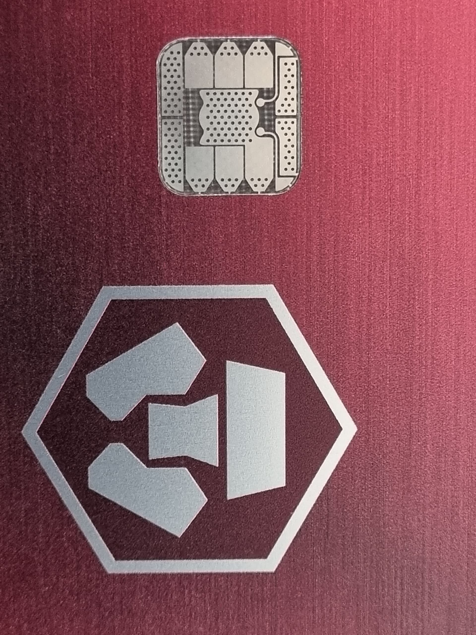

Window in top layer exposing the Infineon chip

I think the simplest answer here is probably the right one, looking at mine I’d say that the top layer is metal with a window for the chip, as you said, and under the plastic laminate back (which I suspect is plastic so that the magnetic layer can be easily magnetised during manufacture and adhered to the metal) is covering a milled out slot for the chip coil antenna, which is why contactless only works with the laminate side facing the reader. Presenting the card to the reader the other way would put the metal between the coil and the reader.
I suspect there’s a milled slot because you cannot feel the coil through the laminate layer and if you peeled the layers apart (or melted with a solvent) you’d find the chip and coil adhered to the metal of the card, although with what and how easy it would be to remove remains to be seen.

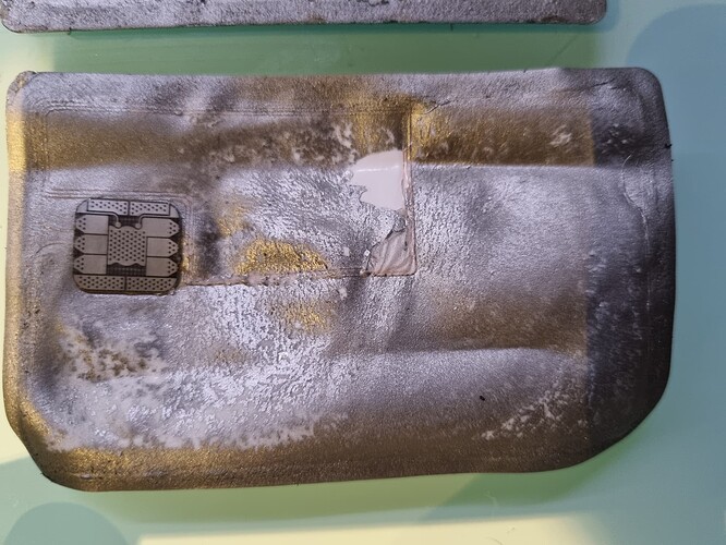

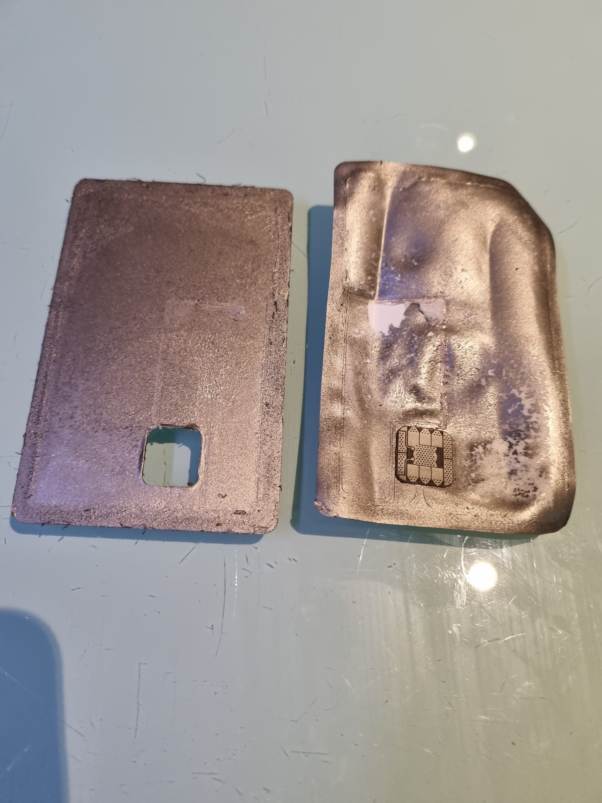

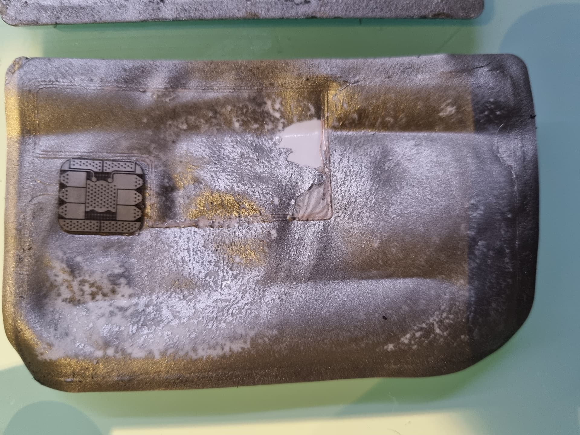

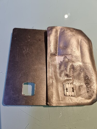

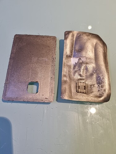

I still don’t really have anything to say, but before I went away, I squeezed in a quick attempt.
I soaked the card in Acetone, and found it actually has 3 layers.
The top layer that dissolved
I assume it was something like a thin PVC
then the middle metal layer
My guess is the bottom layer is Polyethylene, the acetone softened the adhesive but still required some force to peel it off.
The layer itself softened slightly but kept a very strong integrity.
As I was in a hurry, I wiped the top layer off and peeled the bottom layer slowly-ish and was able to push the chip through with it as I peeled it away.
Ideally, I would like to dissolve the bottom layer just exposing the chip and antenna, but it may be successful the way I did it, but needs to be done more carefully.
you can see in the photos below the antenna layout
View of top of metal acetone cleaned
View of bottom with softened adhesive remenants
Antenna layout

Yeah that last picture was what I saw in my head when I pictured the inside of these cards, something that shape/size anyway. I really thought there’d be some sort of recessing given the metal layer. Sure you can embed an antenna into a plastic card but I really figured you’d feel it if it wasn’t recessed with these metal cards.

I can’t make any recommendations until you reveal the reverse side of the contact chip. I need to know how the antenna is connected. That’s a pretty unique contact module. They didn’t plate the contacts with hard nickel or whatever they usually use, they just left them as PCB features. I’d be interested to know more
