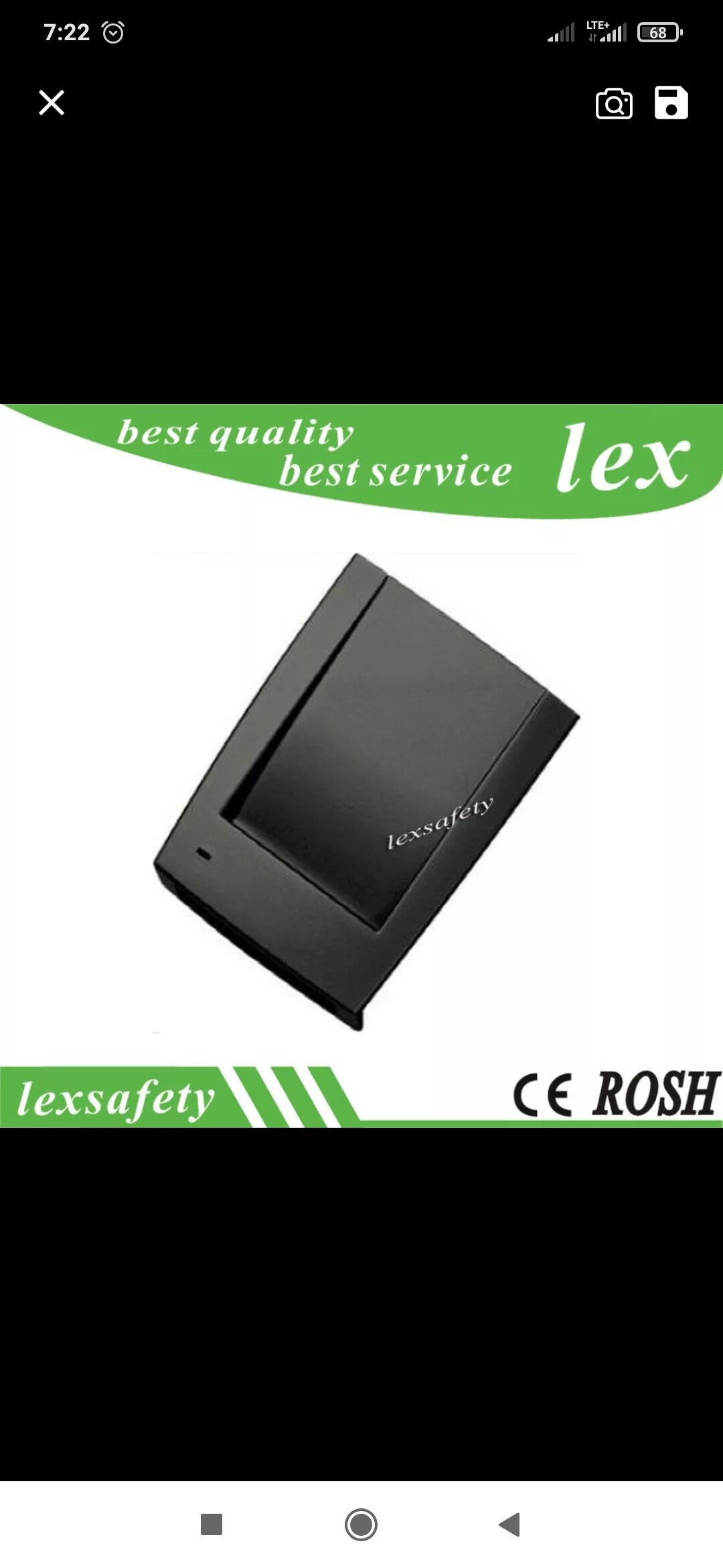

I bought several tags from Aliexpress but they do not work with any system.
I would not like to use cards, just a ring tag. I bought a reader from Aliexpress and I was able to notice that the page 4 & 5 changes with each use. All tags have the same values ​​for pages 1, 2, 3, 6, 7. The Aliexpress reader can only change the values ​​for pages 2 & 3 others are blocked.
Do you have a link or picture?
