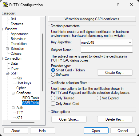

Being on Windows I use Putty for all my SSH needs. I found this fairly well maintained version of Putty that includes a bunch of smartcard support across all the Putty utils…

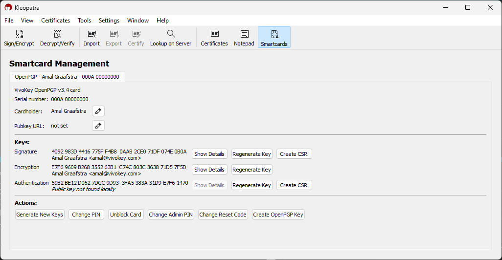

The kleopatra cert manager supports smartcards and all the key management aspects therein… although here again the rubberband sling solution was necessary for efficient use.

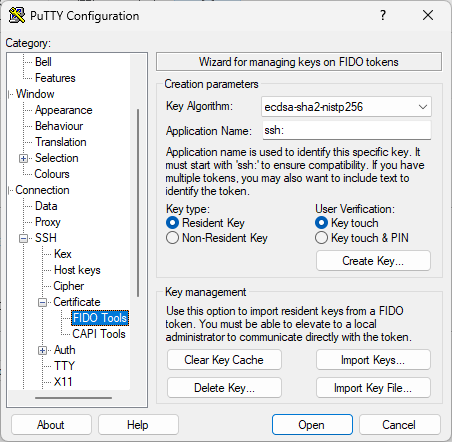

Right out of the gate, putty-cac shows some interesting new security options!
