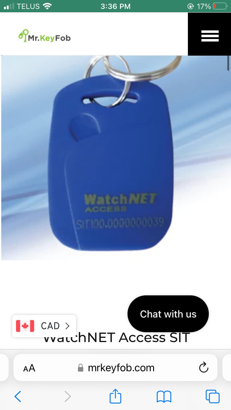

Trying to clone a blue watchnet access sit 100 fob but neither lf search or hf search’s will detect it , if anyone has insite on this fob feel free to share.

Do you have a photo of the wall reader?
Watchnet use both HF and LF readers, plus they also use multiclass readers

Can you pry the fob open to see inside?
