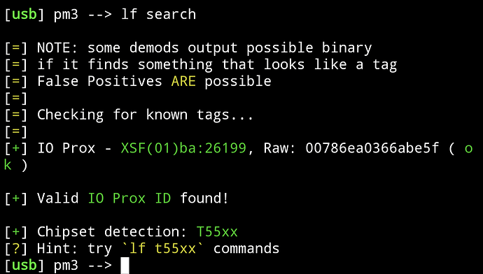

do lf search it will show you the layout of ioprox cards

A little more info:

ok that dump is wrong.
did you do lf t55 detect prior? if no it wouldn’t dump correctly. anyways. commands incoming
lf io sim —vn 01 —fc 186 —cn 26199
vn - version number is just the generation of ioprox chip being used
fc - facility code. all creds in the system share this it tells the system it belongs there. yours is ba so i converted that to decimal so it can be parsed correctly.
cn - unique card number. what identifies you as an individual in the system.
edit: each - is 2 -‘s the formatting is ugly and joins them

I see, I believe I understand how to “decode” that information now, I’ll have to do some playing around
